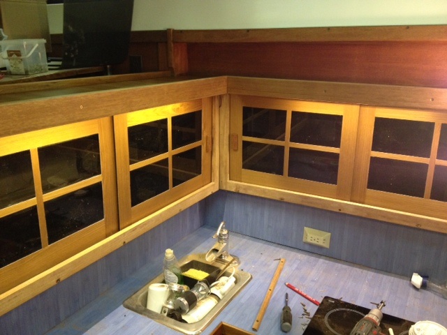

Re: Refinish Interior on F32
Still working on mine, but even adding more teak!
- image.jpg (103.4 KiB) Viewed 6403 times
