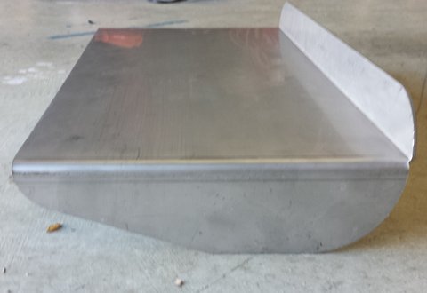

Re: 11 Meter Trim Tabs Anyone ever upgrade?
Follow-up..
Well I went with the Bennett 12 x 30" tabs as suggested and they fit perfectly. Finally this boat will have the proper sized trim tabs.
Thanks for all the help guys... Cant wait to test the performance...
Patrick
Patrick
- New Tabs
- tabs.jpg (71.33 KiB) Viewed 10135 times

Re: 11 Meter Trim Tabs Anyone ever upgrade? Follow-up !
Looks good. I am very interested in the results. I went with 12 x 24 with drop fins. I was concerned about rudder clearance with the 3" drop fins.I too am awaiting testing and will post results as well.
