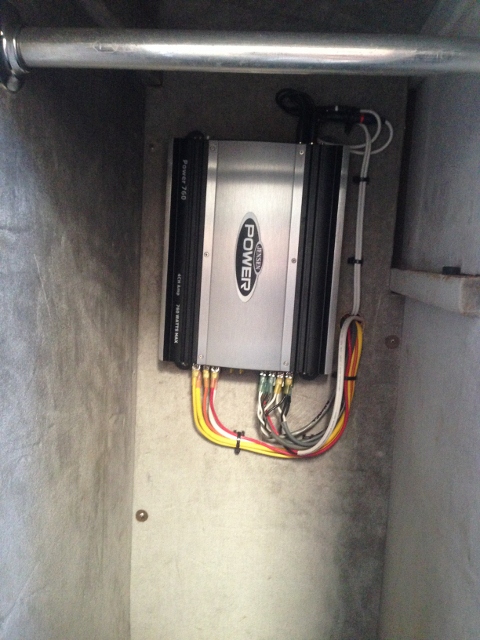

What model do you have? On my 10m mid cabin , I mounted it inside the locker next to the stairs. I installed a 10" subwoofer behind the "L" bench which is on the Stb side on my boat.

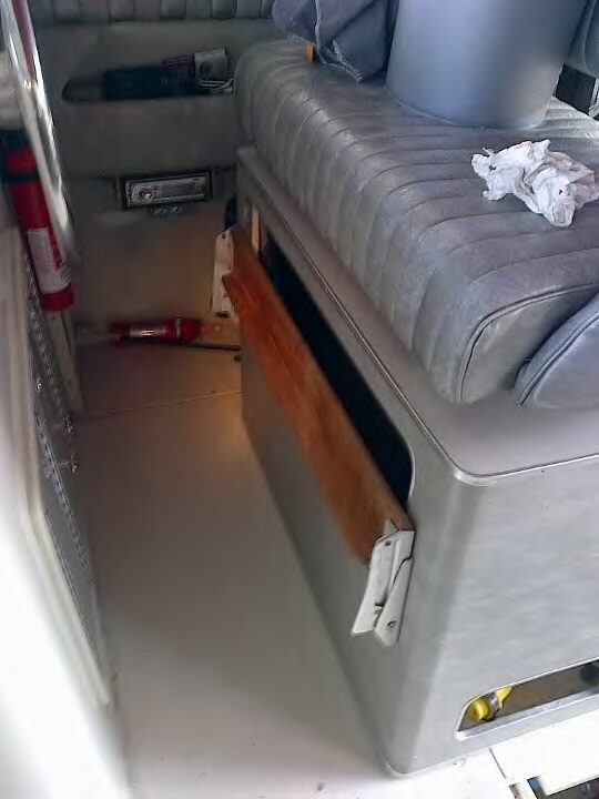

On my 1983 10m Express Cruiser it is located directly below the receiver, in the stbd side closet of the fwd cabin

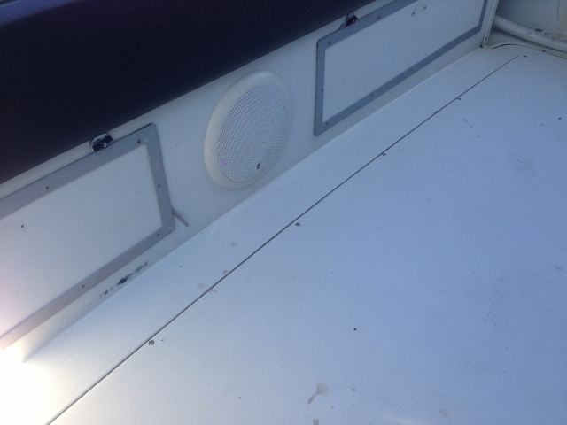

I have 2 speakers in my cabin and 6 mounted on my deck. I also have a small powered sub under my rear seat just to fill out the bottom end. I use the 4 outputs on my stereo to power the 5" speakers and the 4 outputs on my power amp for the 6x9 speakers. I mounted the power amp to the right of my stereo, behind my helm seat. I probably have a 10' fused run to the battery for the power amp. Sound pretty good for not having a ton of money in it.
