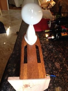

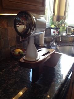

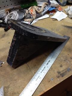

The searchlight and mount were toast when I bought the boat. The searchlight worked but didn't turn.

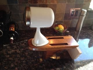

Took it apart and worked on the clutches and it's as it should be. It was also a rusted mess. Sanded it down, primed and painted it, and it looks like new.

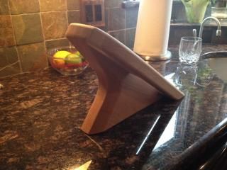

For the mount I used white oak, shaped it, stained it, and coated it. Waiting to get the shrink wrap off the boat to install it.

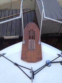

New Bow pulpit. Again with white oak. Planning on putting an anchor roller in it this summer. Get the anchor off the deck. Also a windless eventually.

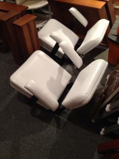

Refinished the fly bridge captains chairs. Believe it or not with upholstery paint. We'll see about longevity?
