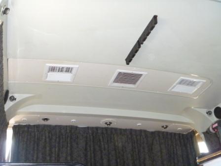

I would probably suggest installing a self contained unit somewhere rather than a split unit. I'll post some pictures of my ceiling evaporator unit tomorrow so you can see what it looks like. You might be able to find one from a 10 meter sedan that is being parted out. To custom make one would be more work than it is worth in my opinion. It is actually two evaporator coils in parallel that share an air intake. I'll try to post some pictures and more info tomorrow night.

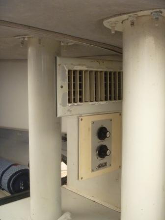

Here are the pictures:
Berth AC has one vent that runs to the dinette area and one that runs to the berth. Control is manual and located in dinette corner. In the salon the evaporator unit is actually one shared air intake and two evaporator coils each with their own blower.

Hey Srokag44, Thank's for spending the time to take and post pic's, it is all pretty clear now.
I'm going to install a 16500 in the icemaker cabinet and a 8500 in the stateroom cabinet as factory.
