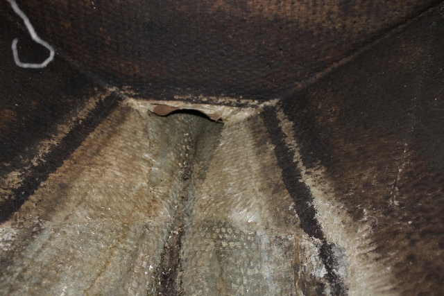

I would put something very high on your list. Remove the limber hole tubes, clean them up and epoxy the visible plywood. Then reinstall tubes and re-bed with caulk (I used 4000). These are out of sight out of mind but the source for stringer rot. The factory caulk is long since shot.
Another thing I have discovered (and now fixed) are the low points where the stringers intersect each other. That's another source of water intrusion that needs to be corrected ASAP. Stand by, I'm going to post a YouTube video on both over the next couple of days...
Believe me, I was In your position five years ago and did all the fun stuff first. But protecting the stringers and deck coring should be your #1 priority.

Bob, thanks for the info on the Fusion system. And especially the limber holes. That is Excellent advice! Definitely something that I would not have thought of and exactly what I'm looking for! I did take a picture(attached) of the forward bilge area just to see what type of shape it was in and know exactly what you're talking about. Kiwi, I would love to hear more about your boat as well and how you like it. I've attached a few pics for you as well. It's actually me that's trying to hold off on the fun stuff (as much as possible) and focus #1 on updating safety systems then mechanical and general convenience items. My wife's concern is flooring, the velvet walls, the dinette table top and a new sectional!

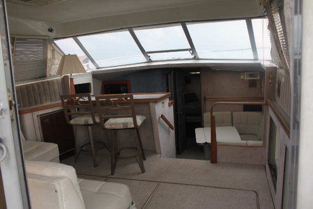

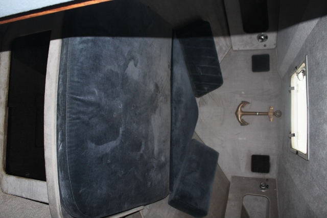

Has anyone modified their master (only) stateroom for a little bigger berth? I'm only 5'-8"! Did they really only sell these $150,000 boats to single Jockey's?

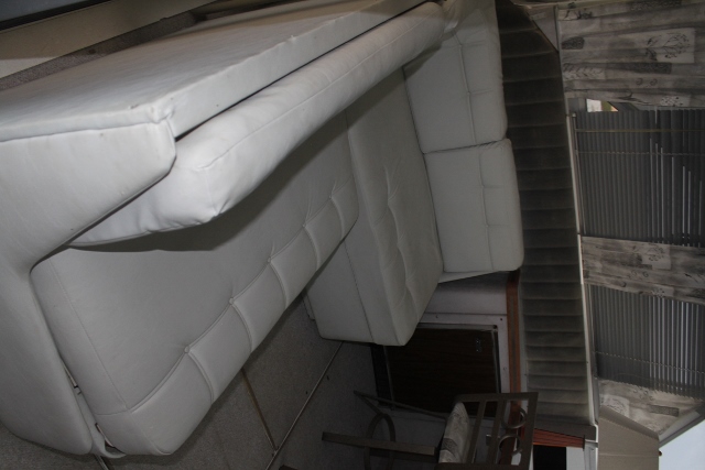

Floors are easy. They make vinyl "teak and holly" that would look good. You can also make or buy a nice teak table top for your settee. You can also order a custom mattress that is bigger and wider. Or just buy a larger size pillow top and put it in top of the existing mattress. There are lots of posts on guys redoing walls with vinyl or veneer that have come out beautiful.
