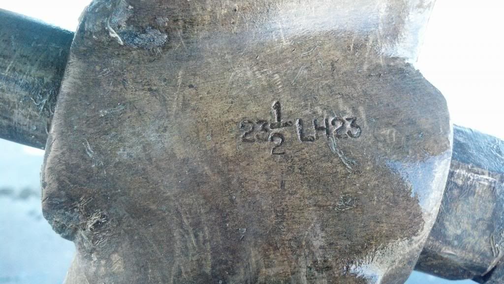

When I cleaned up the boat this spring for paint etc I forgot (we are new to the boat) to write down the prop size. It's either 18 x 19 our 19 x 18. Either way it looks like w we might be undersized. My buddy with the Bertram has the same engines as I do. What is the harm in undersized props other than lack of speed?
1988 F36 w/ 454's
Re: Original Props?
What harm is under size props ? None . What is the gear ratio? as it could have been changed .

kboette1
Posts: 41
Joined: Sun Dec 08, 2013 6:53 pm
Re: Original Props?
Post by kboette1 »
I did the same thing, except never got a close up of the prop. I'm so bummed about it. I'm planning to do a little diving in a month or so but I am also curious as to what everybody else is running. They seemed a little slow to respond. I'll get the gear ratio when I go down on Friday. Thanks guys!

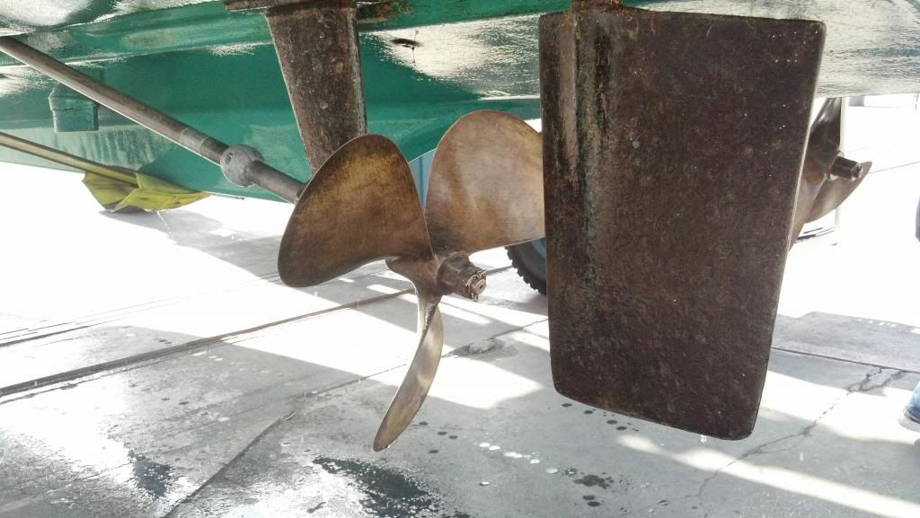

larryeddington
Posts: 1876
Re: Original Props?
Post by larryeddington »
Notice prop nuts big one, little one then Cotter key. :?

larryeddington wrote:Notice prop nuts big one, little one then Cotter key. :?
and... :?:
boats a 1984 and the props are still there ! :D
1984 Silverton 37C
Silver Lining
Scott
Re: Original Props?
and... :?:
And they are on wrong :mrgreen:
larryeddington
Posts: 1876
Re: Original Props?
All that said they do have the final stopper, DA COTTERPIN! :D

Fyi if this helps... Big nut, then small, then cotter pin.... The right way... Lol it's amazing where that discussion shows up!
1988 F36 w/ 454's
Re: Original Props?
kboette1 wrote:Fyi if this helps... Big nut, then small, then cotter pin.... The right way... Lol it's amazing where that discussion shows up!
Small nut then big nut is the correct way :D
