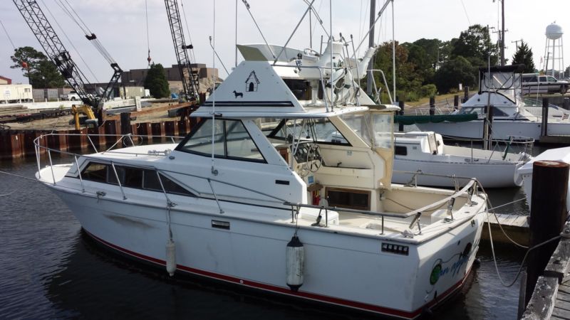

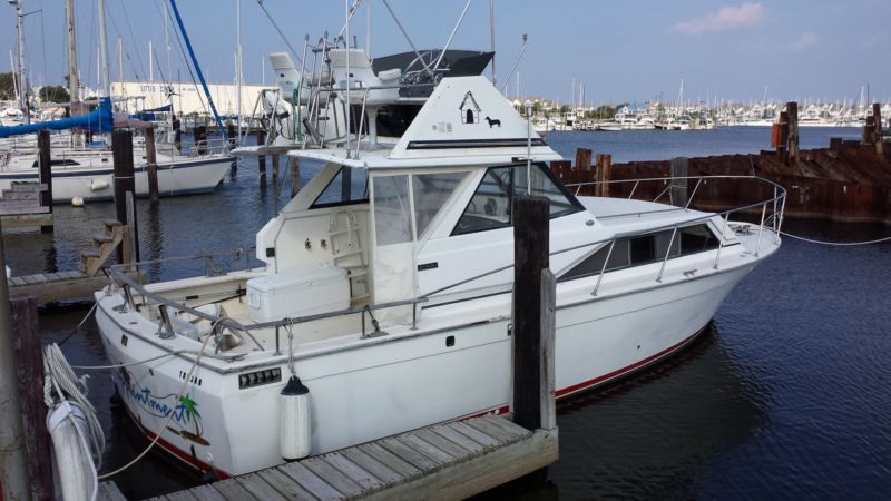

Hey guys been a couple months since my last post but figured I'd update everyone and ask some more questions. First I'll start by saying I bought a 1973 trojan f31 and everything ran and worked great when I inspected it in person. I currently have it docked in Norfolk, VA and haven't had the chance to transport it to Savannah yet. Me and a buddy decided to load up the 4 cylinder car this last weekend and try her out in the chesapeake bay for first time but hit a ton of snags.
To start with we got there and one engine wouldn't fire so we jumped the other engine off and let it idle while we diagnosed the no start. While the engine was idling we heard the belts start squealing horribly and noticed the raw water pump was now leaking. We shut it off and found out that the other engine wasn't getting fuel. I ran to the local auto parts and grabbed a cheap mechanical fuel pump but that didn't help at all. I then decided to blow into the fuel lines to see if they were maybe clogged but we could here the bubbling in the tank. I currently have the marina techs diagnosing the no fuel problem and locating a raw water pump. I really hope that tank was just out of gas. I did try to remove a plug in the top of the tank to see but it was stuck good.
I wanted to also use this post to see if anyone knows if it's possible to put maybe four 60 gal tanks under the deck to increase the cruise range? We are wanting to get into some part time tuna fishing and trolling for tuna all day can really suck up some petrol. Also is there a direct swap transmission available that maybe has 2 speeds instead of 1?
I now offer a little friendly advice to any new twin inboard owners. Don't try to leave the dock with one engine lmfao. Me and my buddy looked like 2 little fishies strung out on a trot line trying to get that heavy boat back in the slip.

Sounds like there is no check valve at the tank . Most likely not the problem but also needs to be addressed for safety as does auto fuel pump . I believe you can increase the fuel capacity , measuring is the way to figure it out . You would be better off replacing the tanks due to age (assuming oem) with larger ones . See what the marina techs say about the issue
2 speed trans ? I know of none for you application . Not sure how far you have to go for tuna down your way , but the F31 is not really a off shore boat . You would rally have to pick your days carefully .
Is the Boat at Cobbs in little creek ? Looks like it from the photo
