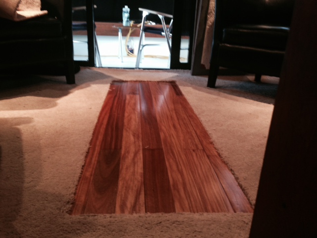

Yes, I actually use her for pleasure, so I bought a remnant and cut and placed it in. I built the hatch top out of wood flooring, and then cut the carpet so I could open the hatches if needed. That was in the salon. In the lower area of the cabin, that is a solid piece. Let me send a picture.

pic

Thats very nice. I like it.
What do you do if you need to access to the entire engine? Does your whole carpet lift up? Or is your carpet cut around the large panels?
I am thinking of of cutting the carpet and tacking it down to the large panel doors so I can lift everything out and pop it back in.

I cut the large hatches in as well and used snaps to hold the carpet in place. I also put hinges on the hatches so I can just tip them up.

Very nice. Any issue with the carpet fraying where you made the cuts?

A little...but not worth the worry, much better to have the cuts than remeoving the carpet when you need to get in there. I trim the fray when it gets bad, but after a month or so its pretty much stops.
