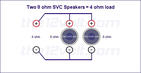

There is a way to use 8ohm speakers to be 4ohm. If you are going to use multiple speakers (qty 4) it would be feasible. Hope this helps. - Lou
Installed link below.
http://www.the12volt.com/12voltimages/2 ... c_4ohm.gif
