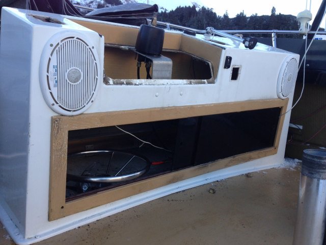

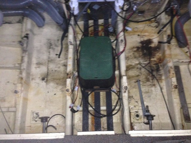

- Day 4 - Dewiring complete
- DAY 4 (6).jpg (55.37 KiB) Viewed 11250 times

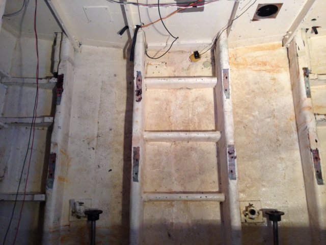

- Day 2 - engines out
- DAY 2 - ENGINES OUT 6.jpg (66.41 KiB) Viewed 11250 times

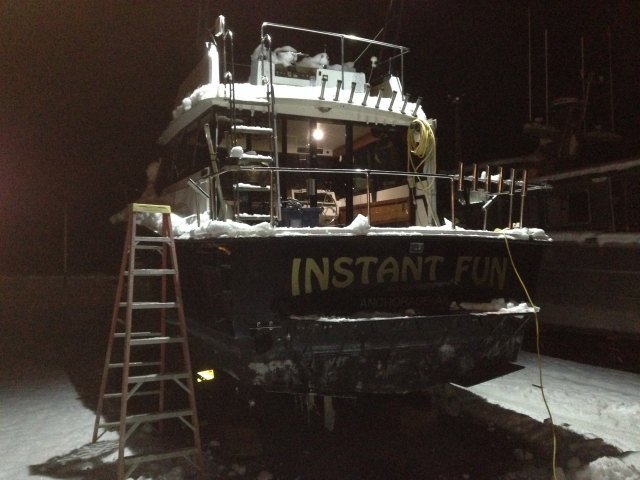

- Day 1 - Getting organized but dark at 4:15 p.m.
- DAY 1 DEC 20.jpg (56 KiB) Viewed 11250 times

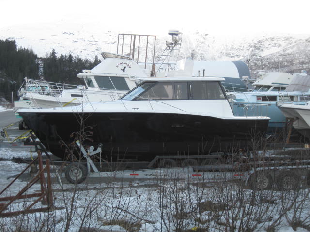

Day 5 - For some reason I could only post 3 images when the topic was started. You can't tell from the picture, but the wind is screaming. It has actually blown all the snow away.
- Invisible wind - gusts to 60 kts and cold
- DAY 5 (5).jpg (71.45 KiB) Viewed 11248 times
- Day 5 - Almost ready for paint
- DAY 5 (9).jpg (57.21 KiB) Viewed 11248 times

I take it you've sounded the stringers and bulkhead? Moisture readings would help too.
- DAVIDLOFLAND
- Posts: 352
- Location: Anchorage, Alaska
Re: INSTANT FUN REPOWER IN PROGRESS
I pounded on them, and found no softness anywhere. Everything appears solid. Unfortunatley, moisture readings ain't gonna happen this year.

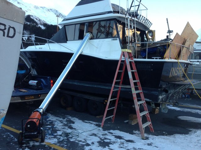

Love that you are taking on such a huge challenge. Know that you are in the REAL great white north, but indoor, or indoor and heated storage are not an option? With the amount of money you are about to spend and work you are about to do, getting the boat in to an environment more conducive to that has to be possible. The results of some of what you are looking to do is very temperature dependent... Work done under the wrong conditions tends to lead to re-work...
Regardless of what I say above... GOOD LUCK! If I am ever in Alaska, I want to see it!
- DAVIDLOFLAND
- Posts: 352

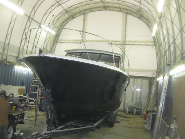

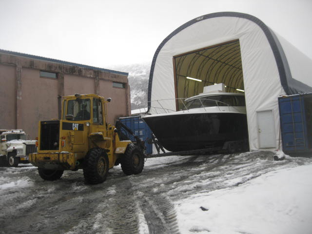

Problematic as the temperature and weather is, it's still doable by heating just the areas where I'm working. There is one structure in Whittier that I could rent. It is a quonset stlye tent set atop 40' conex's on 3 sides. When I painted the Instant Fun four years ago, it rented for $2k/month and it cost almost another $2/k for diesel to heat it with space heaters. Also, it would put me in more of a rush than I want to be in.
- DAY 31 (17).JPG (53.79 KiB) Viewed 11242 times
- DAY 31 (2).JPG (53.65 KiB) Viewed 11242 times
