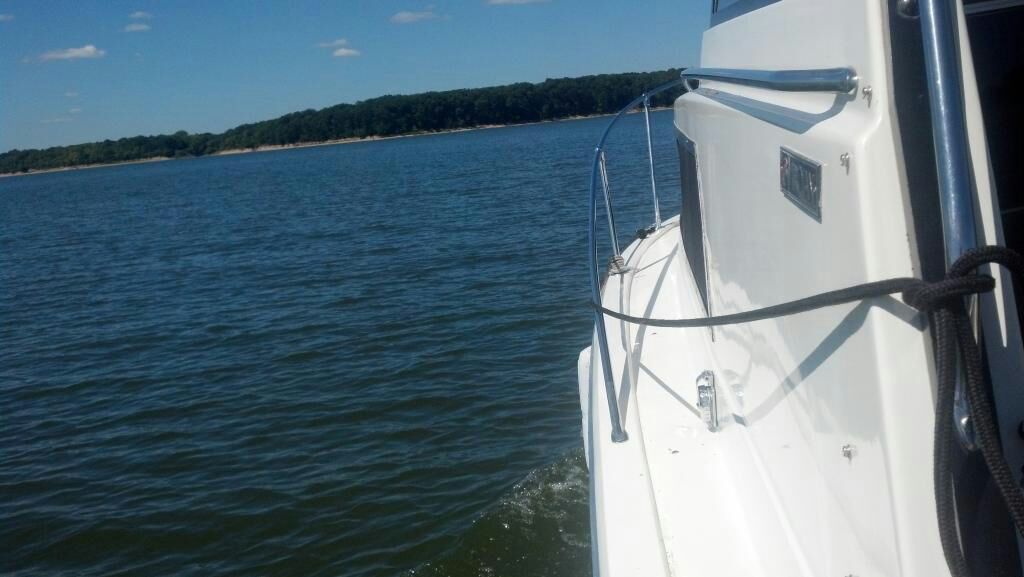

I second the 3m restorer and wax, I had great results, my only complaint is after essentially bleaching and scrubbing the hull and top sides was the tannish color of the wax made the non skid look super white making everything else appear off white.. This product after a good scrub with a scotch brite pad worked great
- IMG_20140907_125646_565_zpsh2514jtc.jpg (68.11 KiB) Viewed 6240 times
