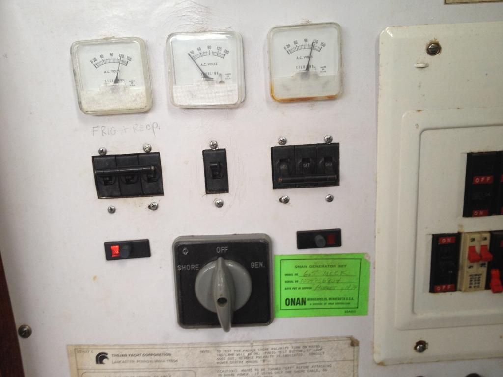

I I have a few questions.
I have 2 shore power connections. One on lower deck stbd side
The other on the port side next to wheel.
Which one goes with the shore power, off, gen. Switch on the panel?

I brought shore power in on the stbd side via a pigtai which is plugged into a extension cord which goes to yard power.
In the shore position the breaker trips. In the off/gen postion. I have power. There are two red lights on. One constant the other intermittent. I can hear a low humming noise. I think it batter charger. I have no power at ac outlets or lights.
Soliciting all the info I can...

Could be reversed polarity at the source or the pig tail ?

Good idea the pigtail jack seemed loose.
Any ideas what red lights indicate?

Reversed polarity .I beleve red staying on is reversed polarity . But I would have to look at my Trojan book to be sure , Mine never worked right ,so I made new ones with 2 colors , green is ok and red is not .

my 1976 f32 had the same set up.......... sort of. as did the tri cabin i grew up with. the constant red light is indeed POLARITY REVERSED.

Thanks for confirming that Aaron , I was pretty sure but not 100% . I like the ones I made green and redaaronbocknek wrote:my 1976 f32 had the same set up.......... sort of. as did the tri cabin i grew up with. the constant red light is indeed POLARITY REVERSED.

Update on power. Turned out had a polarity problem on a extension cord I repaired. Now fixed and have power. Battery charger works. Warm weather has deck drains working. Batteries have been pulled to see which ones are salvageable. Any ideas on my next move?

Just for the record, my 84 tri-cabin has two 30 amp connectors on the stern starboard side. You can use only one and combine the plugs if visiting where not dual 30 amp service. I checked and both are the same phase, in other words not two 120v phases (equals 220v) but the same phase leg, it allows double ampacity to 60 amp. However using the circuit combiner switch on boat to only one 30 ampacity.
