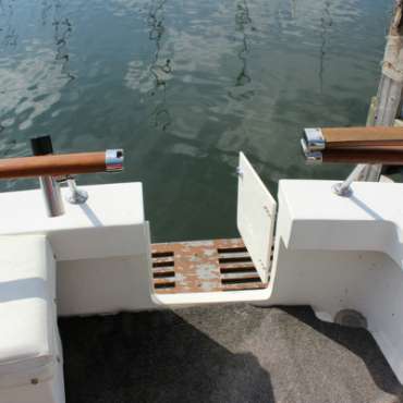

I was thinking of cutting out a swim platform door thru the transom, I have added a picture I found on the net of an F32 with the door, I would like to know if there was an option to have these doors done at the factory when the boat was ordered or these doors were added on by the owners. Was wondering about the integrity of the transom wall and if anyone has done this, I know Paul has done this upgrade on his F26 and it looks Fantastic, he has a single engine, as you all know F32 has 2 engines so was wondering if this would make a difference. Any advice would be great

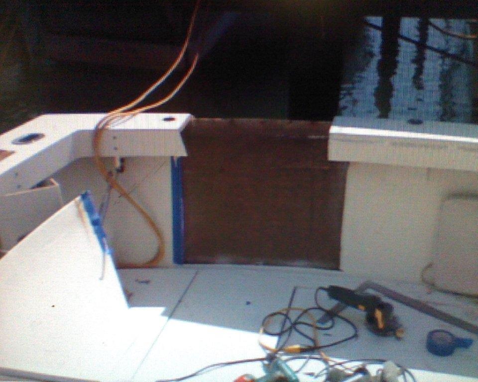

Re: Thoughts and Opinions
Inner liner cut out , larger then the door , note the upper part is all ready cut

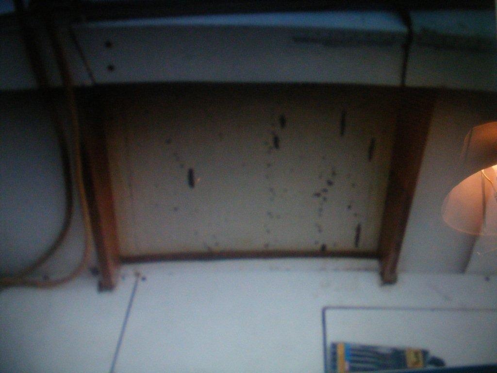

Framing in the door . Notice the transom is not cut yet ,What you can't see were the deck is fastened to the transom with wood and west system and glass . What you can see is marine plywood .

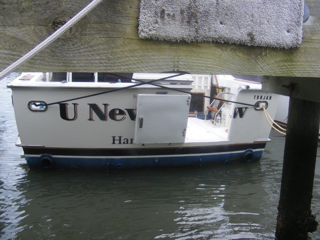

Now I said the first cut is the hardest ,but the cut in the stern was not easy on the nerves at all LOL
If you noticed I also put in hawse pipes .
Of all the things I have done to this boat , this has to be one of the most useful . It makes it much easier for Her to get on and off the dingy and floating docks . I have no regrets
That looks awesome Paul, did you use the inner and outer skins you cut out to make the door, what did you use the pipe for, I can believe the first cut is the hardest, but man what an addition
Only the outer skin that frame also to hold its shape and make stronger (before the cut ). The hawse pipe has nothing to do with the door it self . The hawse pipes are where the ropes go thru . You can see them in the last photo , sorry about the poor first 2 photos they were from my flip phone .
