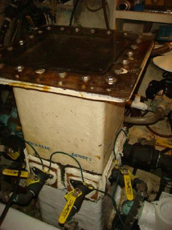

hey all. brad and i went to the bay bridge boat show yesterday and had a great time. out of all the vessels there, our favourite was the DEFEVER 46 pilot house trawler. brad loved the galley and all the storage areas, and i loved the engine room, complete with workbench and tool drawers. though it was not a walk in engine room, there was plenty of room to move around and access all systems. one of the most unusual items in the engine room is this box, fabricated out of thick fiberglass and raised above the water line. the top is a thick plexiglass bolt on hatch to view the seacocks attached at the bottom. there is a screen attached to the bottom to act as a strainer. for the life of me, i cannot figure out the name of this device. can anyone out there assist? is this an 'AQUA BOX'? i've never seen this set up before. also, ALL the overboard thru hull fittings above the waterline have ball valves on them, i guess for ocean crossings? thanks guys/gals. much appreciated. (the attached picture came from a search of pre-owned defever boats world wide as i did not have my cell with me yesterday)

Re: WHAT IN THE NAME OF MARINE ENGINEERING IS THIS?
Its called a Sea Chest

Is the idea everything draws its water from one supersize strainer?
Basicly yes

I am kind of shocked that you had not seen one . But then again I have only seen maybe 2 in person as they are most offer only on very large Vessels . Mostly I have seen them I yachting magazines . A friend on my dock has a 49' Defever that has a sea chest along with a very roomy engine room .

So if I understood right, machinery like engines, air, generator, etc, draw raw water from this one location?

Yes all water is pulled from that one location . I don't think you will find them on many sub 60'boats I was surprised to see it on the 49 Defever . I believe Viking may use them on larger boats (60+ ) .

It is called a sea chest. all sea water cooling water goes thru it. Great safety idea. Just one hole in the bottom of boat is much better than a bunch.
So the box goes all the way through the hull?
Yes its really part of the hull , it has a grate below . The top is above the water line ( on the defever ), so you could remove it to clean , But the there is no way I would . something about a 12"x12"+ hole thru the bottom scares me . And if I was wrong ........... :mrgreen:
