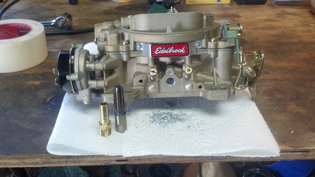

Here's my idea, I initially sweated the cost, but it made such a huge in improvement with hot starts, fuel economy, I couldn't have been happier. Edelbrock 1409, everything bolted right up , fired right up,

44Ydnar88 wrote:Here's my idea, I initially sweated the cost, but it made such a huge in improvement with hot starts, fuel economy, I couldn't have been happier. Edelbrock 1409, everything bolted right up , fired right up,
Looks like you had to drill and tap for the PCV port? Also, electric choke...Just need switched 12vdc run to it?

1/4 pipe tap, brass barbed air hose fitting. I used the 12v side of the ballast resistor,

Well then, local shop "The Carburetor Shop" in St. Paul had a refurbished 1409 for $199 including base gasket, needless to say i purchased it, already drilled and tapped for PCV. Going to install over the weekend and hopefully have good news to report. In other news, still fighting an intermittent ignition problem...Have replaced the rusty reluctor and pickup as well as the coil, cap and rotor, wires, plugs...some days it starts, other days it does not, no rhyme or reason, I always check voltages when it wont start and everything seems normal. Seems to me that a previous owner replaced the distributor with an automotive version since the marine part# pickup does not bolt in as designed and the shaft seems to be a bit to big for the marine part reluctor wheel, the 1975 charger/318 slides on but not firmly. Thinking about just scrapping the OEM ignition and getting the Pertronix version, less parts to rust out...Not sure if they make one for this motor either...Anywho...Going fishing this weekend for that gremlin, would rather be fishing for walleye...
