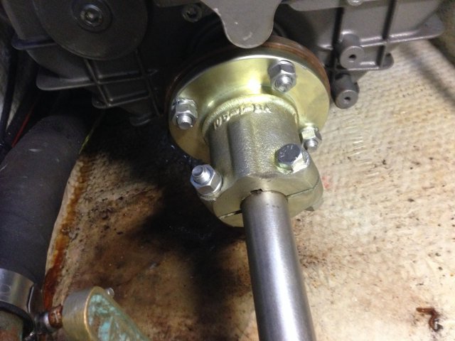

On the subject of shaft couplers... I was getting some pretty severe vibration from one shaft, so bad I thought the shaft was bent. There was also a film of black dust appearing in the bilge below the coupler. I suspected the old 38 year old solid coupler might be part of the problem, so I decided to change it before hauling the boat to pull the shaft. I did have to swim under the boat to slide the shaft zinc forward to provide clearance to slide the shaft back far enough to change the coupler.
Old solid coupler changed changed to new split coupler. Vibration GONE. Now I'm gonna change the other one.
