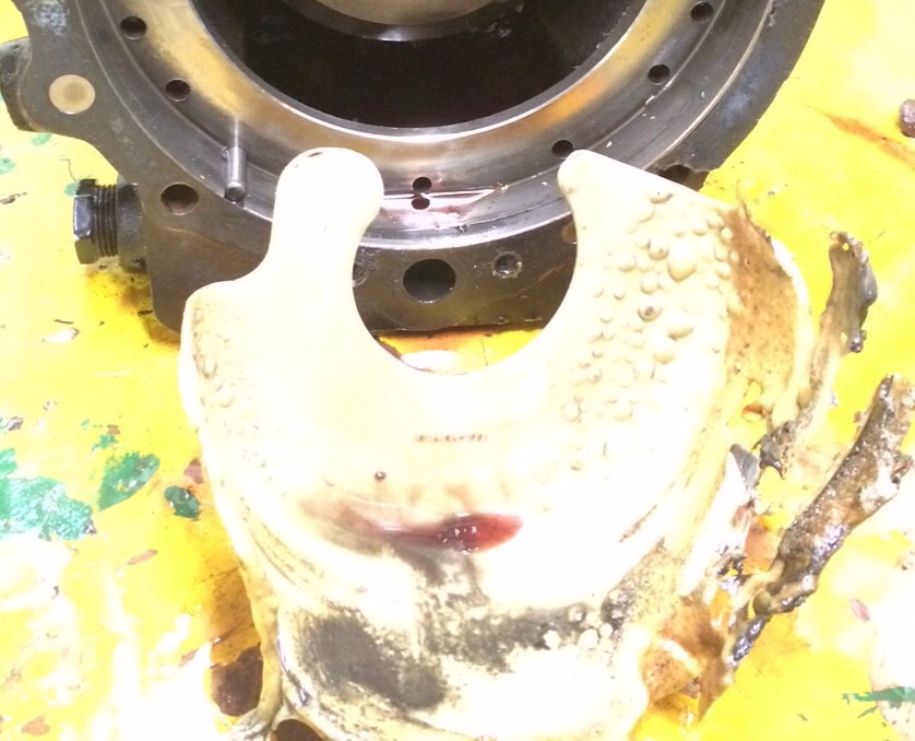

Ok I got it apart. It seems the very low oil level caused it to get a bit warm, well very warm and down right hot. Hot enough to melt the oil baffle as seen in the pic. The melted baffle was holding the ring gear from moving to the reverse position. So experts, is the baffle necessary? gonna try to find a new baffle, and already have a rebuild kit on order and will rebuild the unit since it is this far down, but Im thinking a new baffle may be harder to find. however the other existing parts still look like new.

I would replace it . You haven't pulled the clutch pack apart yet have you ?
Re: Velvet Drive replace rebuild?
Found one on Ebay, so yes, Yes, clutches are all out waiting for the new set. Hope to get it all back together next week. All parts look good yet, just the melted baffle.
