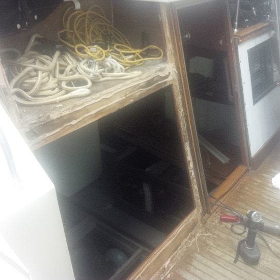

I have just finished removing all the wood from the back of my tri fly. I wasn't gentle about it though.
I did see that with some time and care, the aft cabin wall, the exterior wall with windows and the rear deck could all be unbolted/screwed and removed.
The screws are brass and you only get one shot at removing them, if they skip once you have to drill the head off :(
I have some pictures of mine here

I have bought the 440's and have began the process of removing the "good" 400 engine and looking at the 440 install. They are 2" wider so some interior woodwork will be required. I removed the aft bulkhead (lots of glue for sure) in hopes of being able to install both 440's through this space without taking them apart.

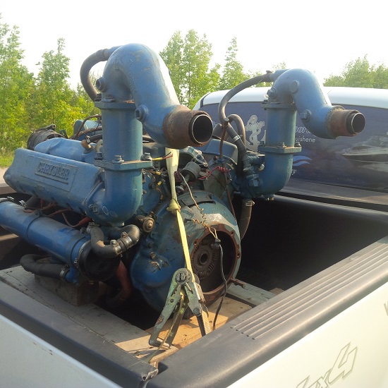

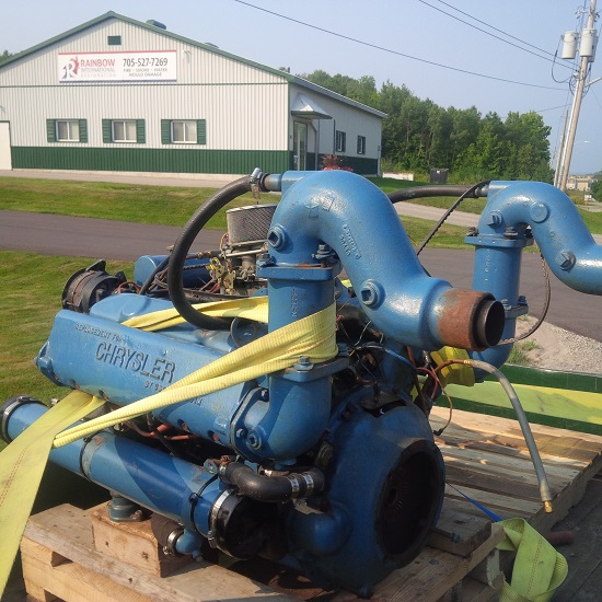

Hey guys, I think I figured out the pic size. Here are the 440's going in. The beginning of taking out the aft bulkhead for an easier repower. The 440's are 21/2" wider and higher. The Riser spaces are an easy removal.
Both engines were run up with Oil Pressure gauge attached
the door frame has been removed since this photo
Engines are as clean as the replacements.

Closed cooling Too. Makes them a bit tighter but great to have. :D
