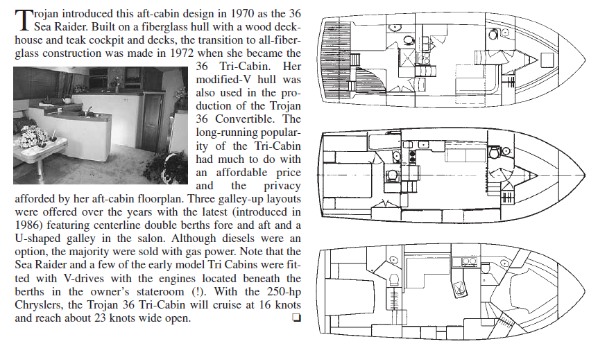

Hi guys,
Trying and flying here. Figuring out the aft filler cushion config is a challenge though. The PO supplied me with a cushion, but no "board"(what she called it) to span the walkway between the twins in the aft stateroom. Can anyone explain if this is a normal or custom config, how it works, and possible improvements?(PO described it as least comfy bed ever)

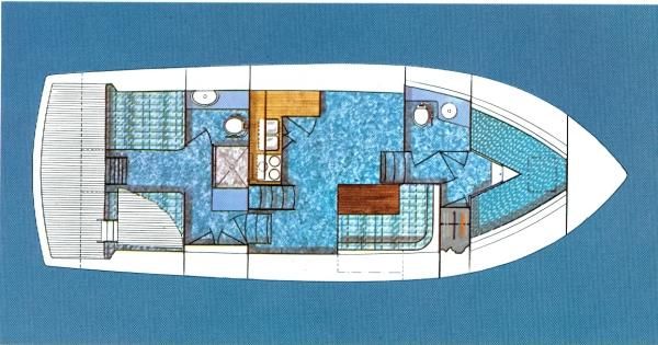

Mine is the layout I posted. Engines under each aft bunk w V drives and NOT under the salon floor. There are a few online that customize this to some sort of super king size, but Id like a thoroughfare. May have to pull the trim and put my designers hat on. Stand back if that happens... My vision: A "Tricushion?"

Hey Misty, my tri fly has the same layout as the picture you posted, with the exception mine has a steering station at the "L" shaped sofa in the salon

HERE I AM.............. sorry fellas. it's been a while. i'll explain later. the aft engined tri cabins NEVER had a filler between bunks. the gap is just too big. of course, you could modify something, but it would need to be supported in the center of the filler. then again, we are masters of customizing, so, the the options and ideas are limitless..............

Agree with Aaron but wasn't confident enough to say as much. I sold my Tricabin two months ago and bought another Trojan but my former '74 Tricabin (had it for 16 yrs) was also a V-drive arrangement and therefore like Aaron has indicated, there was no filler pad.
But, I widened the port side berth by ten inches by having a carpenter build it out into the space between the two berths.
Secondly, I removed the hollow, partition that was stock on the outside wall of the berth (thus losing the shelf) - this increased the berth size by another ten inches.
(I installed a new teak section right next to the fibreglass interior freeboard)
All in all, after getting a custom mattress made (and paying too much for it) we had ourselves a pretty big, comfortable berth.
