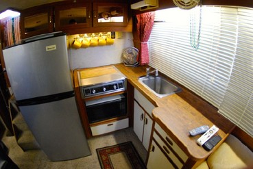

what i am perplexed by now is a picture i saw via a google search of images for "trojan f36" it clearly shows a larger fridge installed in a ship like mine. Heres the pic...

I am faced with the same quandary with my 84 tri cab. At least I do not have to get the old one out as PO did that. Ah but I do have the hatch in top of salon. Hate to take it out but will have to. Debating about frig size. According to all things tri cab Aaron they cam with a regular frig in them not a 12/120 volt. The only one that is 12/120 volt of size is a built in one so then would have to do the cabinet work. I have not decided what to do as yet.

The Tri cabin pictured is a later one with center engines and a hatch in the overhead. This galley looks just like mine and the PO did install a new fridge the looks like the one pictured. He said it took 4 guys and was a real pain. The only way you will be ale to get one in that size is to open he overhead. If mine takes a hike I will repair it in place because of the difficulity of replaing it.
