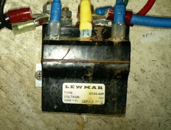

Re: SeaWolf Windlass 520
Hi,
I found what the solenoid looks like. Does this picture jar anyone's memory if they have seen this around their International boat?

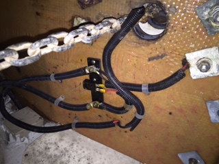

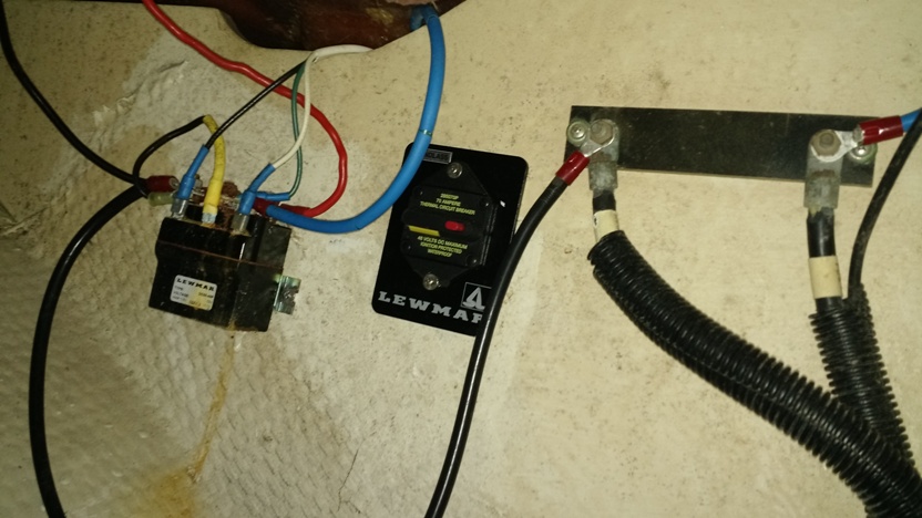

My 12m has a Lewmar, but the setup in the anchor locker should be similar. I haven't run mine yet, so I may be replacing the solenoid and adding wireless anyway.

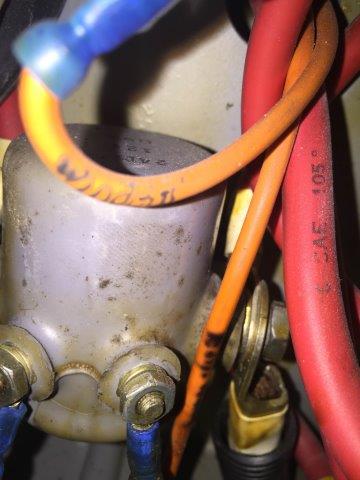

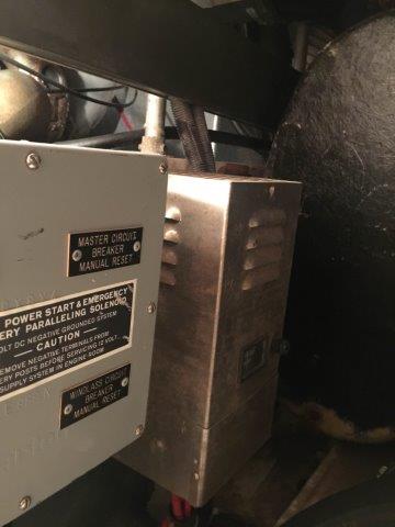

Found it! Well thanks to some electrical drawings Bob sent me I found the solenoid. Hiding in plain sight. It's behind the starboard motor next to the battery charger. Need to get behind the motor and look forward to read it. The solenoid looks like the average run of the mill solenoid, not what I had seen from other website data. I have no power to it. So I think I have a bad switch in the panel. I didn't have my tester with me, so the investigation continues. You can make out the word windlass written on the wire.
I just wanted to follow up on this last project.
Well after I found the relay, I jumped it and the windlass starting working.
I took the foot switch off the deck and jumped that and the windlass started working too.
So after all this, it is just a bad foot switch at the bow.

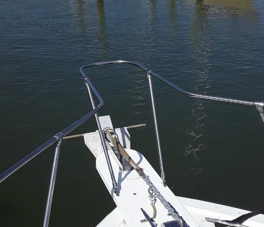

- bow rail new.jpeg (43.21 KiB) Viewed 10130 times
