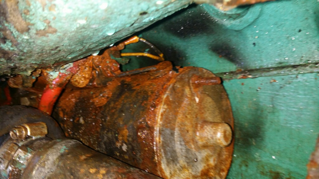

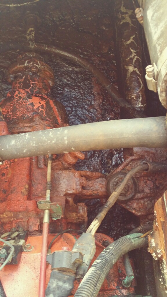

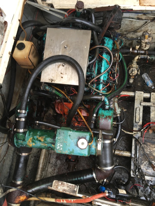

found out I was incorrectly informed about the engines. I had taken photos of the motors and showed them to a detroit mechanic. he stated they were 8.2L engines. we knew the starters were bad as the boat had fresh water in the bilge and they have been covered for some time and are very rusty. got a closer look at the motors while trying to remove the starters and found out these are not detroit's but GM 6.2 diesels. Got a lot of cleanup to do.

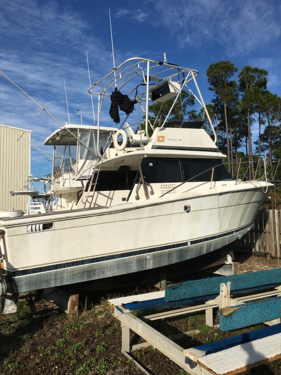

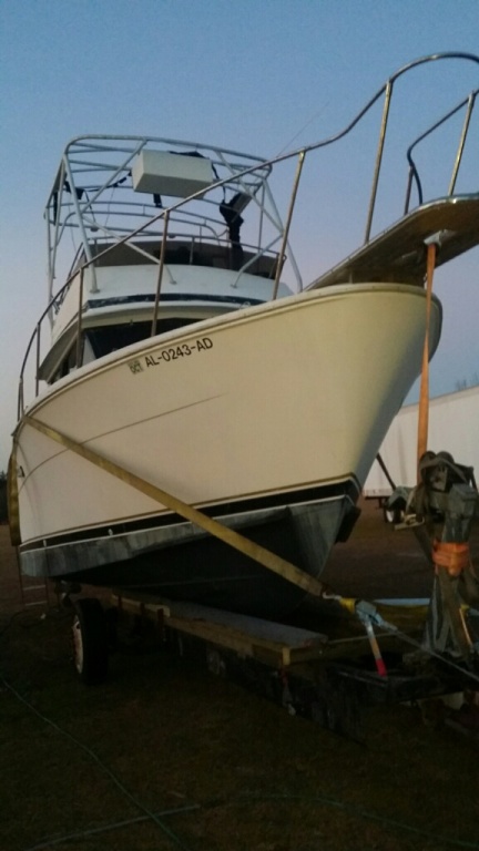

As I found her, and after a bit of power washing

While to do have some work to do , that is a good looking boat with nice lines . The model # 290 means the boat is a F29 Sportman . I agree the engines are not 8.2 liter DD and most likely 6.2 L could possibly be 6.5 as the are the same basic engine . They used the same parts that bolt on . Only difference would be noticed inside . I always liked the 6.2/6.5 .
Re: New member - 1981 Trojan 290
There are a lot of variables affecting whether a hull will warp from being blocked. After four years, I wouldn't leave it to chance. Don't know about down your way but up here, it's a pretty penny to haul a boat out of the water and block on land to be worked on if one were to find an issue after launch. If it were me, I'd do a visual of the strut alignment to the shaft tube now, then remove the shafts and props and send them in to a prop shop for assessment. After confirming they are okay and re-installing them, I'd let her sit in the water for several days before checking alignment and coupling the shaft to the tranny. Normally one would only wait about a day after launching to give the hull a chance to settle back into shape before checking alignment but when they've been sitting on land for a few years, I like letting them sit a few days more. Because of the length of time she's been out, I'd uncouple and check alignment again at the end of the season prior to haul out in case an adjustment needs to be made to the strut which is difficult to tell once she's on land again (we get hauled out for the winter up here).
Before launching, you may want to check other items that would have to be repaired out of the water such as all thru-hull fittings above and below the water line, seacocks, shaft tube hoses, strut bearings, shaft and rudder packing, etc. You'll also want to check trim tab operation if applicable in case there are any leaks that need to be dealt with. You should also take a close look at her bottom for any signs of osmosis that should be taken care of now. If you're in an area that is prone to fouling, now would be the time to prep and anti-foul the bottom. Oh, and don't forget about anodes.
PS, before doing anything, did you get a survey done? Do you know what condition the stringers are in?
Hope to see some pics of her in the water soon.

Going purely from what I can see in the picture, the tranny looks like it's been submerged for a while. Personally I don't know how comfortable I would feel with putting it back into service without assessing it first. Again, remember that all this hardware could be spinning at a few thousand rpm.
I agree with Big D it looks like the water did get well over the trans (and starters ) . All that needs to be looked at closely

just a short update. pulled both starters out. one was shot ( the one pictured in one of the above posts ) and one we actually were able to save. it wasn't as badly corroded as the first one and it cleaned up rather better than I had hoped. Tore it down and inspected and cleaned all parts. put it back together and hooked it up to a battery and it works great. it appears that it was a newer starter and a high torque one. the other was a direct drive. found a place to get a replacement for the starboard starter and have that on order. one of the 1 1/4 hoses felt a bit soft so I'm going to replace it just to be on the safe side. still working on cleaning up the engine room but it does look 100% better than the above engine photos.
