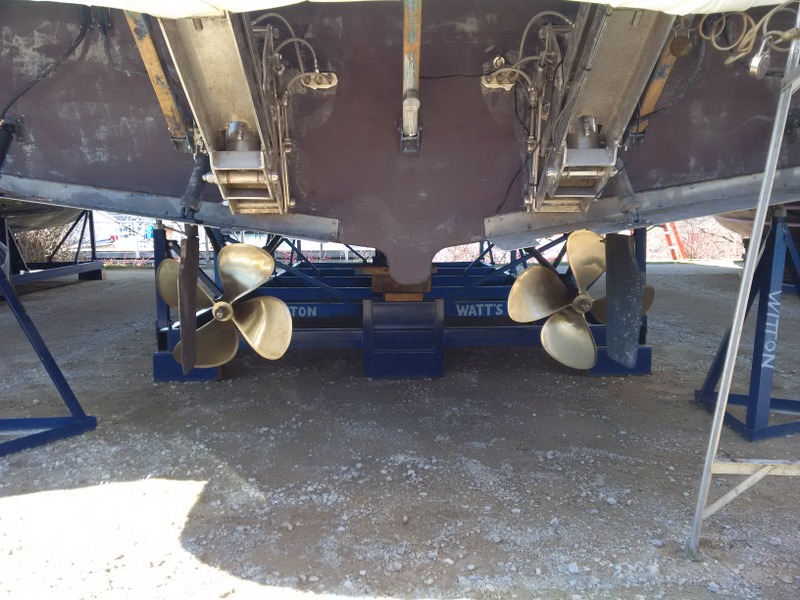

Just a clarification...... my props just arrived and they are....
Michigan Wheel DynaQuad 24" x 24" 4 blade bronze
to match what was there.
Ron
Ron
Re: Prop Replacement
Good to go. Very pretty.
Interesting.... the smaller nut is the prop nut, the larger nut is the jamb nut and goes on last.
RonW
RonW

New props look mintRonW wrote:Good to go. Very pretty.
RonW
