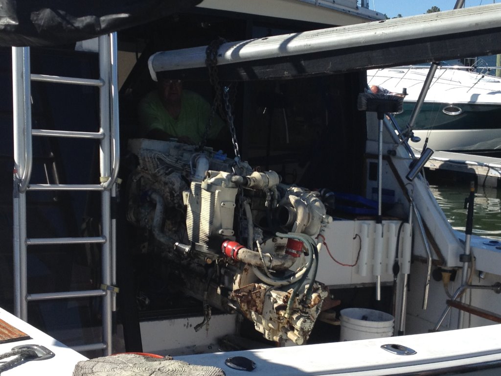

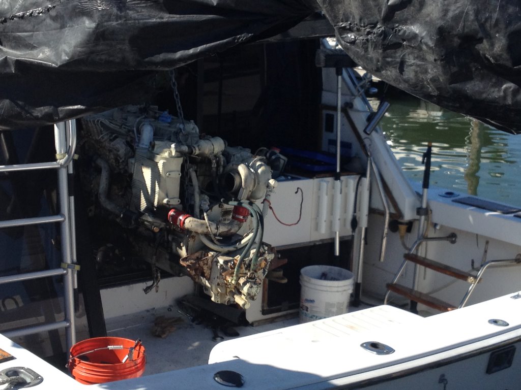

This subject came up a while back on a f32 . My answer was to use a fork lift . At the time I did not expect to post photos . Well a few weekends ago my port engine went boom . So I had a busy day yesterday . I hope to be up and running to day

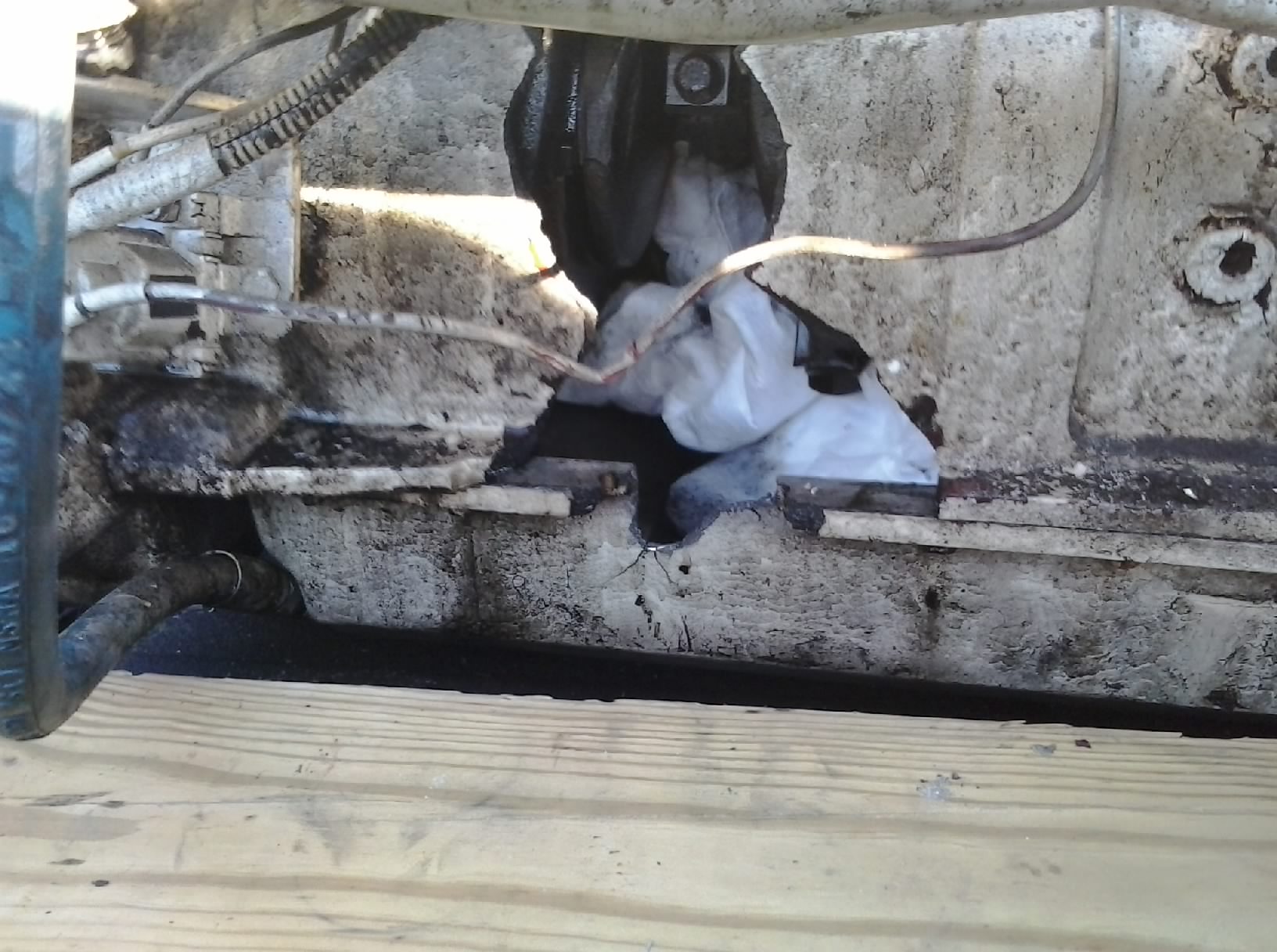

#5 rod left the building
WayWeGo wrote:Sorry to hear you are having to rebuild an engine right in the middle of the season.
Hope you have her back together soon.
No rebuilding this one

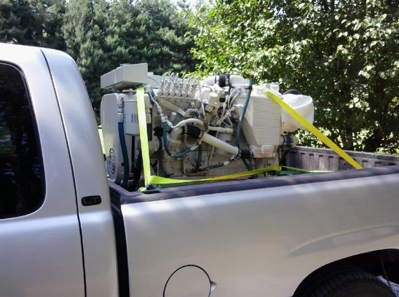

The fix
engine replacement 2.jpg (89.17 KiB) Viewed 7011 times
Re: How do you remove a engine from a F36 .
prowlersfish wrote:The fix
WOW!!!! You keep a lot more 'spares' than most!! :lol: :lol:
While that maybe true , I had to drive 4+ hours one way to get this ( with a lot of $$$). You can bet I will keep a lot of spares off the old engine :mrgreen:

Sorry about that . :mrgreen: I will set the record straight first this happen on Saturday the 28 of may on the Memorial day weekend . Finding the problem was easy once the smoke cleared . Then I had to go engine shopping ( lot of junk out out there ) look at new too .I found this low hour used one 4+ hours away . Made a offer based on photos and video pending hearing run and inspection . found the money . Pick up the engine and left it at a friends ,rented a car then drove to Ct for Wes's funeral . 1300 miles later engine made it home (last Wednesday ) . This weekend made the swap . Its up and running but gauges not working I need to swap senders . Took the boat back to my marina on 1 engine but used the new one for only docking . No sea trial until the gauges100% .

Not much if any warning . loss of power then vibration . Though I got a crab pot in the wheel but the vibration was still the there out of gear . From the loss of power to knowing I was screwed 30 seconds at the most . Still not 100% sure of the cause . Maybe blew the tip off #5 injector or a sudden loss of coolant ( senders don't work with no coolant ) I found the back freeze plug out not sure if that's a cause or a result .
I will up date when I tear it down and figure it out , but that will have to wait a while .
And yes it was a big mess . :cry:

A few theories on what happened . #5 injector may have blown the tip and hydrolocked #5 was my first theory . But I found the rear freeze plug blown out of block so a sudden over heat is possible . no coolant = no / inaccurate gague reading and no alarm . but the plug could have blown out as a result of the engine blowing . I will know more when I take it apart . But that's not high on the to do list . I do know it broke the rod on the wrist pin end so I am pretty sure some thing stop the movement of #5 piston .
