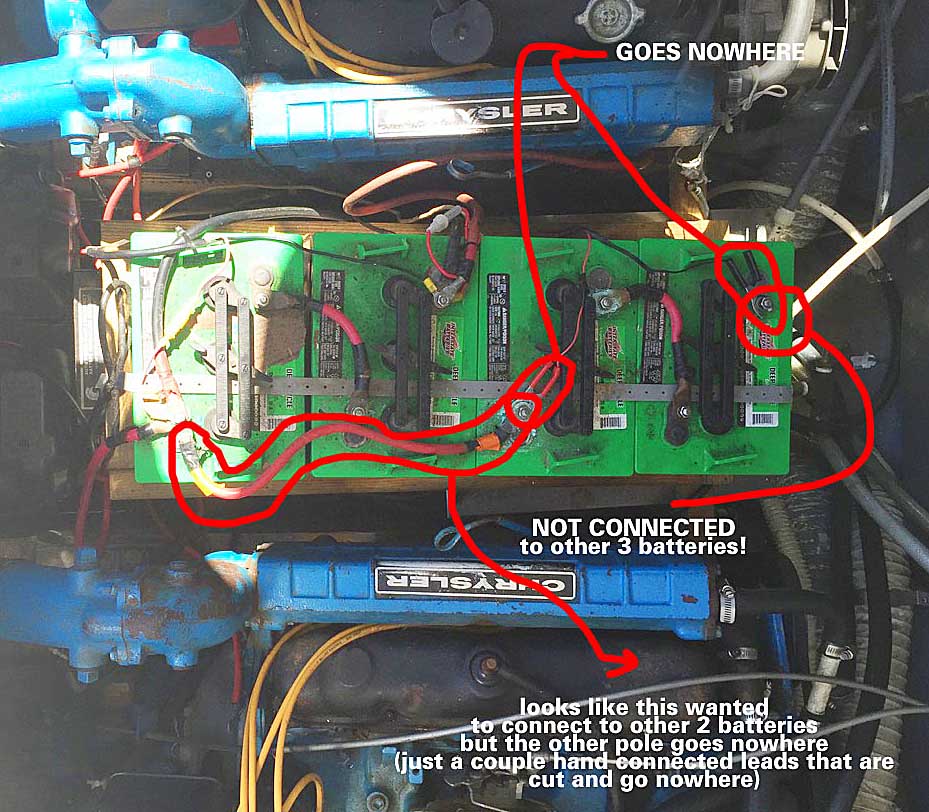

BATTERIES
as to batteries, I have 2 starter batteries, one for each engine.
there is a charger, which feeds both these batteries from one output of battery and the other charger output feeds the house batteries, which there are 4. One of these 4 batteries does not seem to be hooked up... see my diagram
it seems like it would make sense to have all 4 batteries hooked up
The DC power switch is your standard 3 position... battery 1 , battery 2, both
I take it one switches on starter battery?
the other switches on house batteries?
Both turns them both on
is this correct, and best option?

BATTERIES

From my very limited knowledge of 12v stuff, it appears from your pic that you have 4 x 6 volts there, very hard to tell what is going on because of the cable colors . If that strapping being used as a hold down is metal, you need to remove it carefully and replace with something non-conductive . Blue seas site has some example battery drawings as do some others that might help visually with this.

X2 on the hold down strap . That's a fire just waiting . looks like you have 2 banks of 6volt x 2 and they are sort of tied together . Hard to say what is what not knowing whats + and whats - and where the got (I would not go by color of cables )

As for the batteries, that is a little above my head except to say, I think 4 batteries is way too much. You have no room to work in there and it just adds extra weight to the boat.

that was a great call on those batteries be ing 6 Volts!! that did not occur to me, and battery did not say it! (I had to call battery company) - now I know why the readings were so low! lol

The strap on batteries is not conductive

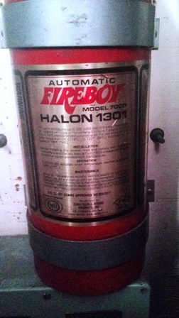

my boat has a fire extinguisher in engine room. It looks to be original. After 40 years, I am thinking it will probably not function. Any thoughts on these things?

I just had my 30 year old Halon one recertified. I took it out and to the local fire extinguisher shop, and they weighed it and gave it a look over.

That is great news and a great idea... I did not know there were extinguisher shops! I will have to google that...

Hard to say what's what by cable colour but from what I can see, if the intention was to have four batteries make up one bank, the two batteries on the right are not doing anything as they are not hooked up in parallel to the pair on the left. If the bottom left terminal on the first left battery is the positive terminal (or is it the negative??) for the 12 volt source, there has to be a negative (or positive) source coming off the far right battery top right terminal, and connected to the corresponding source terminal on the left bank otherwise the two right batteries are not hooked up to the two left batteries.
Get rid of the wire clamps on the two right batteries, they shouldn't be used for wiring. Try to clean up as much of the wiring as possible. By that I mean remove any wiring that is not being used, and connect all the auxiliary wiring to one set of terminals on the batteries or better yet, a set of buses separate from the batteries. It's preferable to have only the necessary battery cable connections at battery terminals so there is minimal wiring running to them. Also clean the terminal lugs or replace if needed. Use marine lugs as they are much better. The cheap bare copper ones corrode too easily. The corrosion will cause all kinds of problems. Use shrink tubing over the lug and cable connection, the good stuff with the adhesive so that it seals the cable at the joint. You should also ensure the proper coloured cable is used for the positive and negative sources. As noted in the pic, you shouldn't have a black and a red cable going to the same terminal. And install terminal covers on all the terminals.
