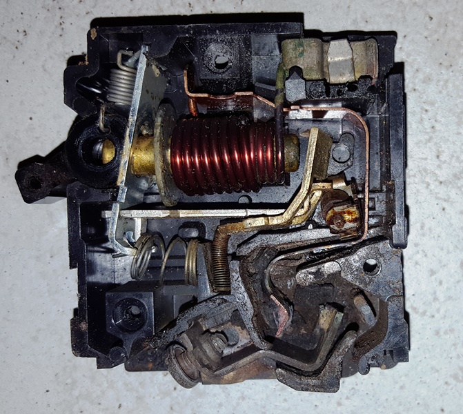

We had a breaker fail recently. The whole circuit was dead and the wire coming into the breaker was overheated with melted insulation. We were quite lucky to avoid a fire since there is nearby fiberglass and a spark could have ignited it. I do not think lightning was involved.
Here is what the breaker looked like when I drilled the rivets -- note the condition of the contacts! Interestingly, the switch felt normal when operated.
- Breaker.jpg (205.94 KiB) Viewed 5966 times
