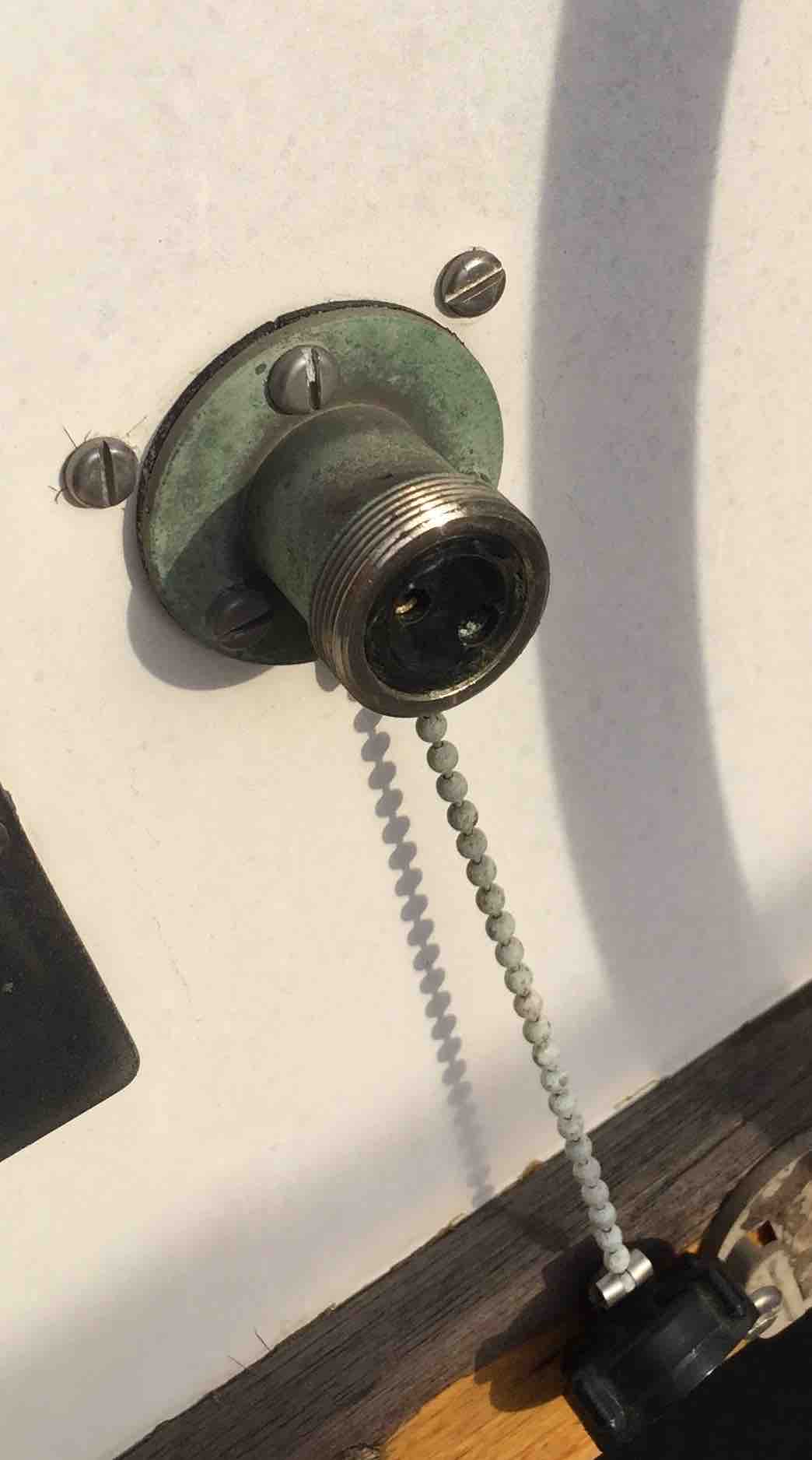

Hi y'all. I just picked up a 1980 F30 sedan cruiser. She needs a bit of work, mostly cosmetic. My question is "what is it". It's a bronze extension on the flybridge dash. Screw on cover. Looks like something with 2 pins plugs into it. Don't know how to post photos yet. Thanks

It's probably your mast light base. The mast light would plug into this base.

I don't think it's a light base. It comes out horizontal and is very close to the wheel. About 2 inches long
- IMG_2399 copy.jpg (61.22 KiB) Viewed 10871 times

If it is not for mast light, it could be an old school fitting to plug in a handheld spotlight. Seems strange to have it on an '80 vintage boat, but I saw a similar fitting on my father's old '69.
Re: New owner-what is this?
Looks like a power plug maybe for a hand held spot lamp ?

If it is for a handheld spotlight, you could replace it with a cigarette lighter or USB charging port. I need to add one to the flybridge as we are always running our phones down when cruising.
It's a proper marine waterproof polarized 12 volt outlet for accessories like spot lights and anything else one wants to plug in temporarily. The larger of the two ports should be the positive side.http://www.downwindmarine.com/Sea-Dog-P ... 00052.html

Thanks guys. makes sense that is what it is. will have plenty more questions.
