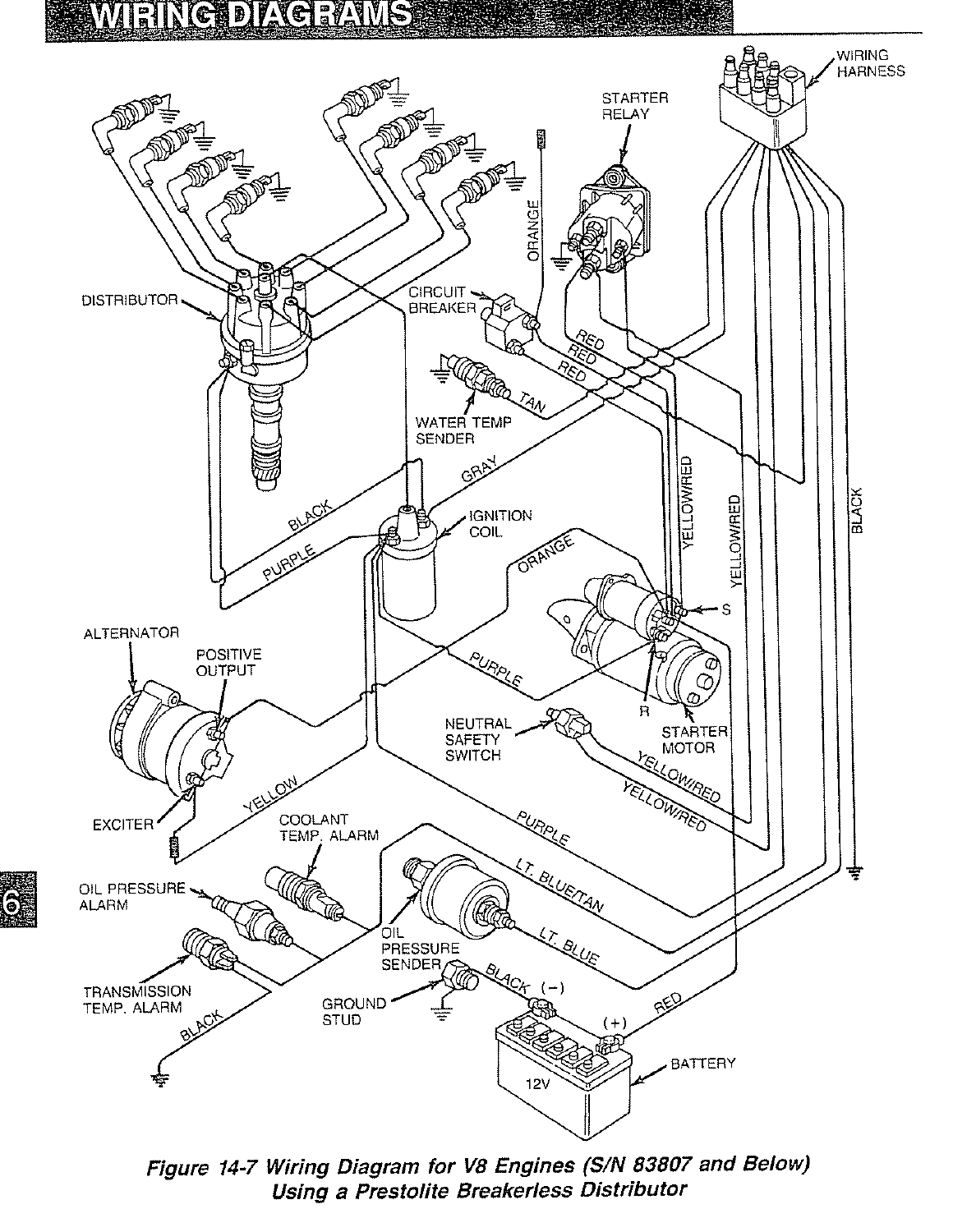

Unfortunately, the wiring diagrams, while very clear on every other section, have so many lines going to the starter solenoid that I can't make heads or tails of it all.
Is there anyone here that has made any sense out of which wires go where? The colors that they are (supposedly) labeled with don't help either because at some point, somebody seems to have just painted everything blue....

This was in the manual but does not line up with what is installed

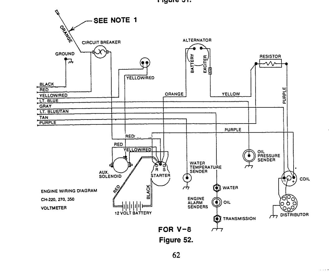

This was in the second manual and does seem to line up with what is installed but I can't make out the terminal orientation on the starter/solenoid.

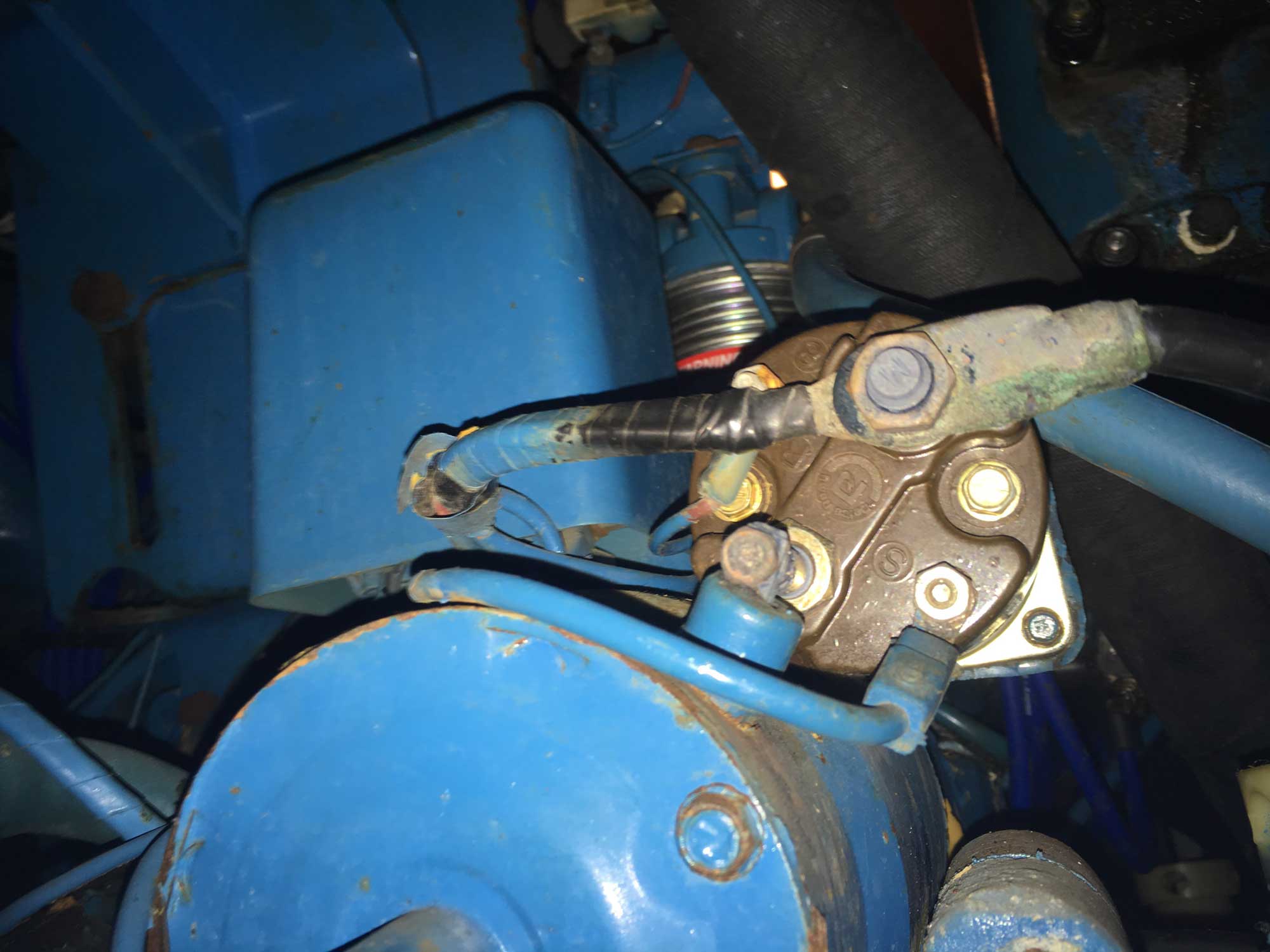

Reality
Reality

Here is my very scientific attempt at very scientifically figuring this out...
Re: Starter/Solenoid One click
You do have your photo labeled correctly . . The ignition feed will not effect starter operation so ignore it while diagnosing the starter . You should have battery voltage (12V) at all times on the big terminal . With the switch in the start position you should have 12 v at the S terminal
Safety switch is on the transmission
The main power wire looks dirty , I would clean the connection

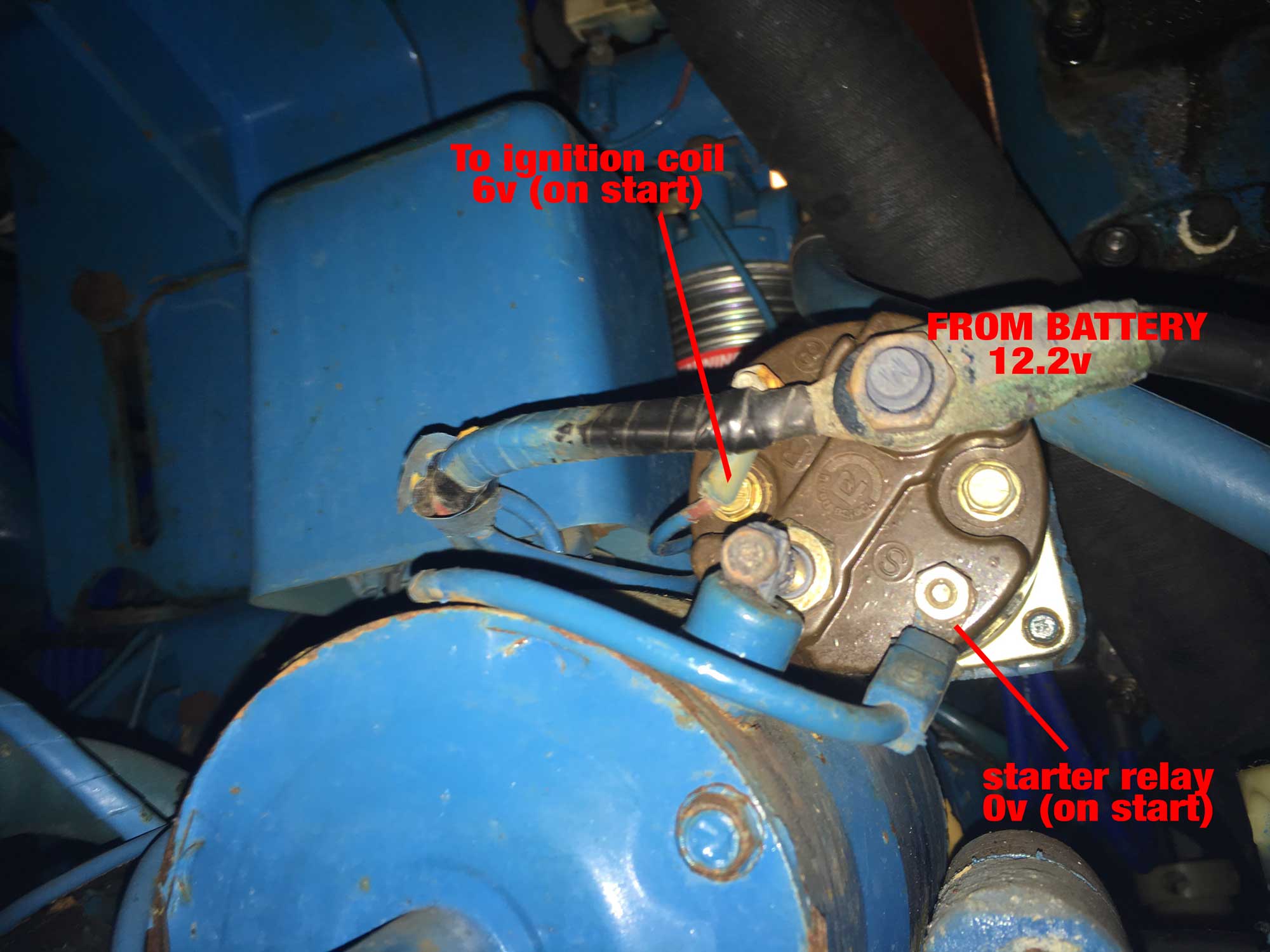

OK, so here's what I measured with the help of my assistant (girlfriend was a good sport.)
To me, this seems to say that there is a problem with the starter relay or the neutral safety switch? I ensured that the gear was shifted into neutral at the console. The 6v (on start) coming from the ignition coil does have me a little stumped though, is that a step down voltage after 12v passes through the alternator perhaps?

The 6 Volt from the coil is normal as its going thru a resistor , nothing to do with your issue that's why I said ignore it . You should be getting 12 volts to the S terminal on start , that is your issue . Possible n/safety switch or starter relay . check voltages there . You photos by the way are a big help
