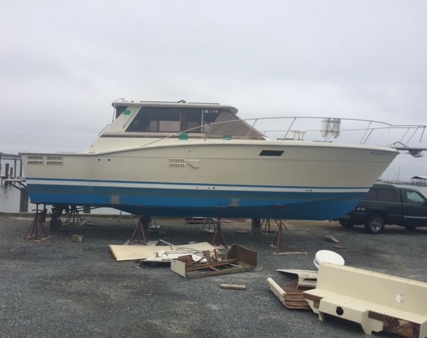

Wyebluecrab
Posts: 6
Joined: Fri Jan 20, 2017 5:25 pm
Re: Removing fly bridge
Post by Wyebluecrab »
Two pics of result.

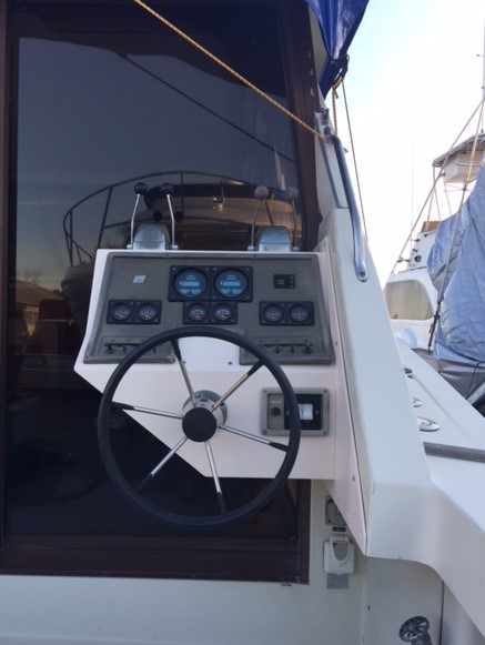

Wyebluecrab
Posts: 6
Console made for what were the bridge controls.
IMG_0921 (2).JPG (71.81 KiB) Viewed 12836 times
Looks very nice! Having the console in the cockpit will make docking a breeze, even if single handing.
Maybe we will get to Rock Hall this summer and see her in person.
oil&water
Posts: 245
Post by oil&water »
Looking good! Like the use of the upper helm. A great docking station.
