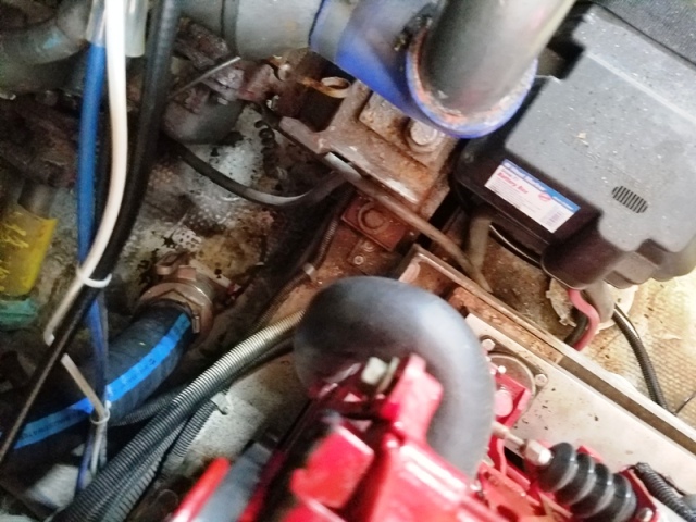

Hello I am new to the board. Recently I have purchased a generator for my 1991 11 meter express. The original owner never ordered the boat with one. Anyway I'm in need of pictures anyone may have of the mounts. Im not sure if they mounted to the stringer or to the side of the Waste tank. FYI the generator is an exact replacement Onan 7 kw. Thanks

I have an 88 11 meter express, and will try to get you some pictures tomorrow. If memory serves me correctly, mine sits in an aluminum drip pan that is bolted to the stringers right above the holding tank.
Stay tuned.

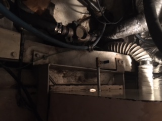

This is on my 1988 12 meter convertible. It is not the original generator, but as Jimmy said, the aluminum frame between the stringers is original. Mine sits above the holding tank.

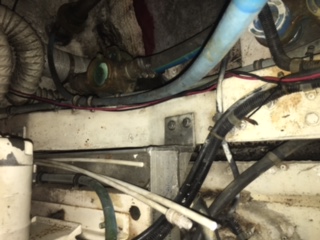

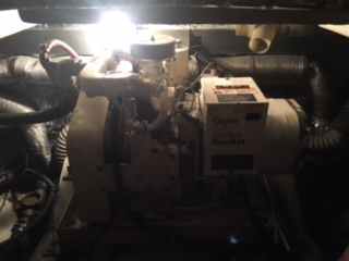

As suspected, the aluminum pan the genset sits on is mounted to the stringers. See photos. Hope this helps

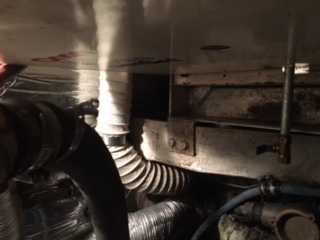

The picture farther back. Sorry about the dark picture. Light off too dark, light on too much glare. I get get another one tomorrow if needed

That should help. If you think of it I could use more but I think I get what they did.

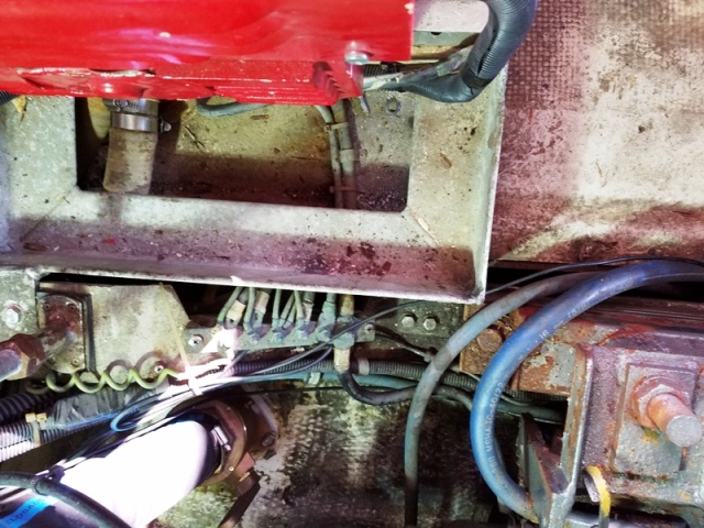

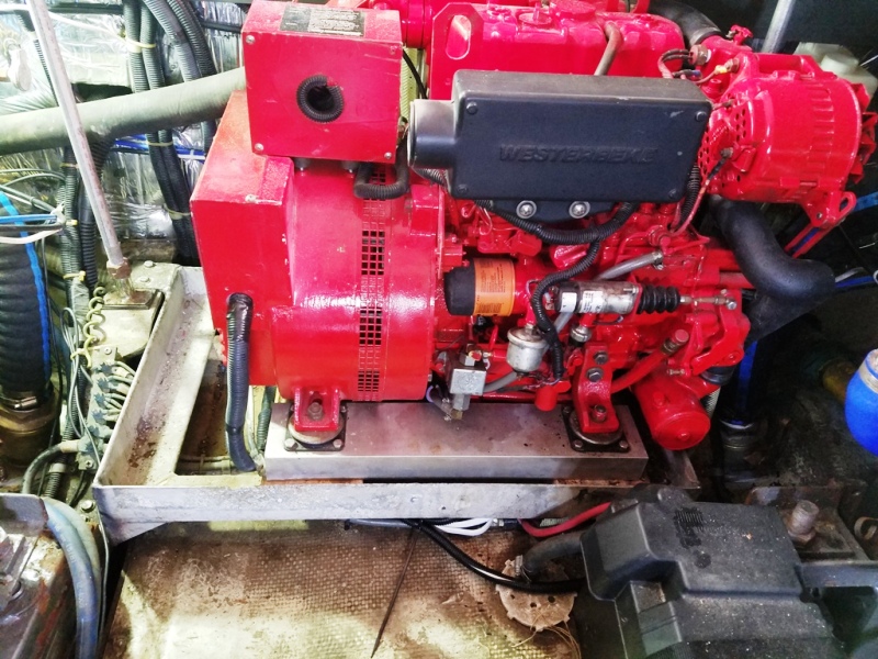

Here is some more detail of the mounts:
