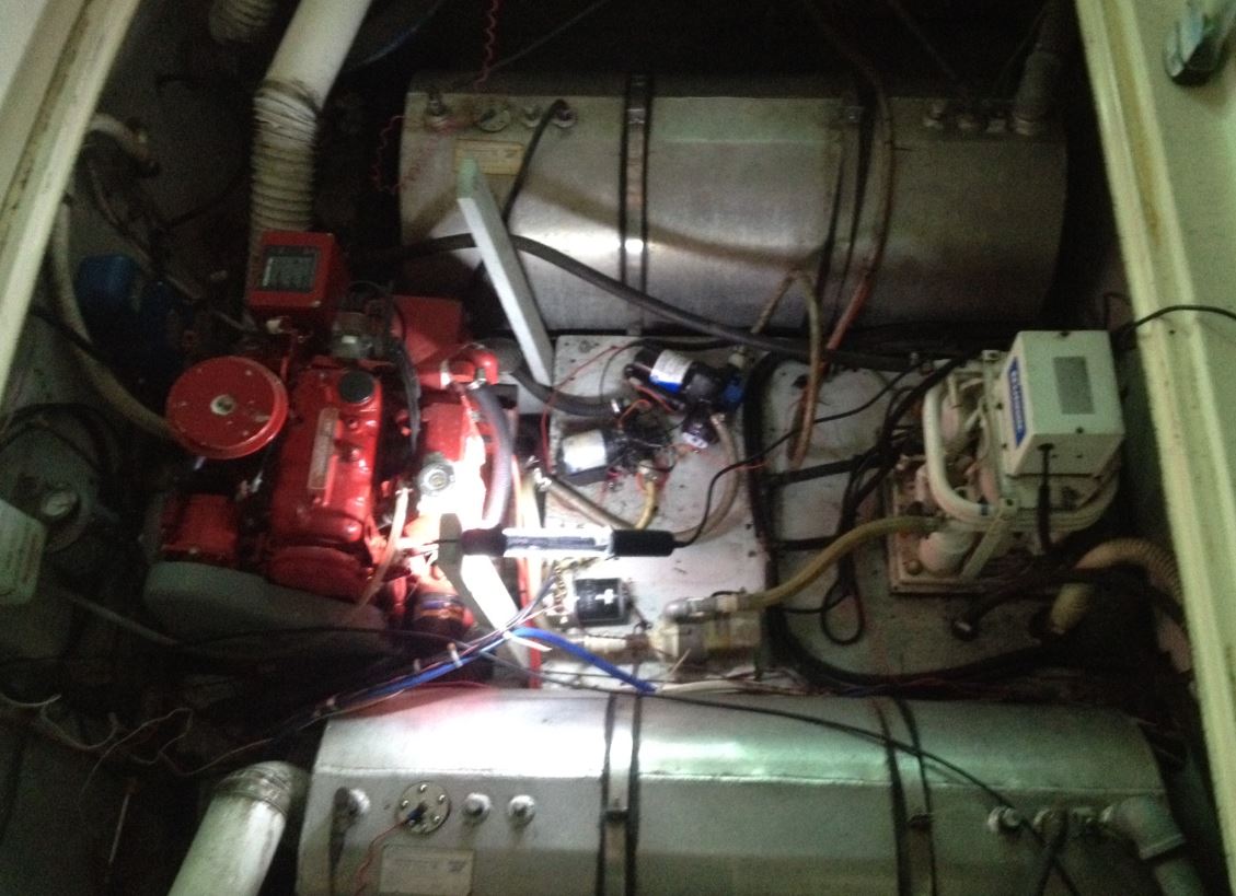

My unit is under the back deck, with blowers in the salon and anchor locker ( venting for salon and berth) My assumption is this was a factory install as documentation shows it was ordered with A/C. This is on a 1988
AC Unit.JPG (128.34 KiB) Viewed 8651 times

Yep, you have the split system. The self contained units take up some real-estate. :D
