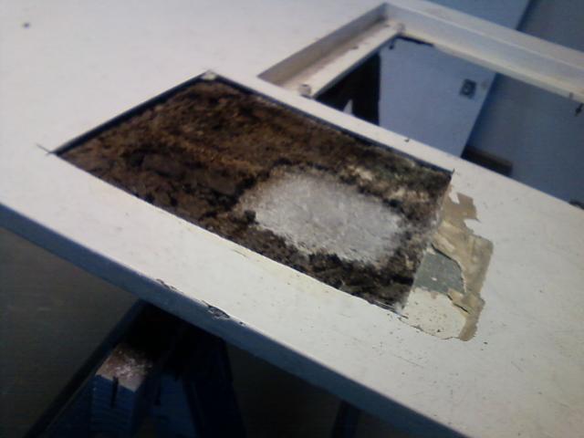

Next step
I wonder what's under there?
This can't be good
This can't be good

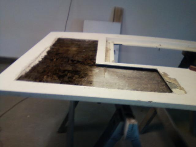

So I wonder how bad this gets?
Think we will stop here
The good news is, should be solid when I'm done

Mostly because the bottom looked better than the top!!!!
PO had made some "customization" that was coming apart at the seams. So my intent was to cut that out and reglass.
First cut :shock:
Second cut :cry:

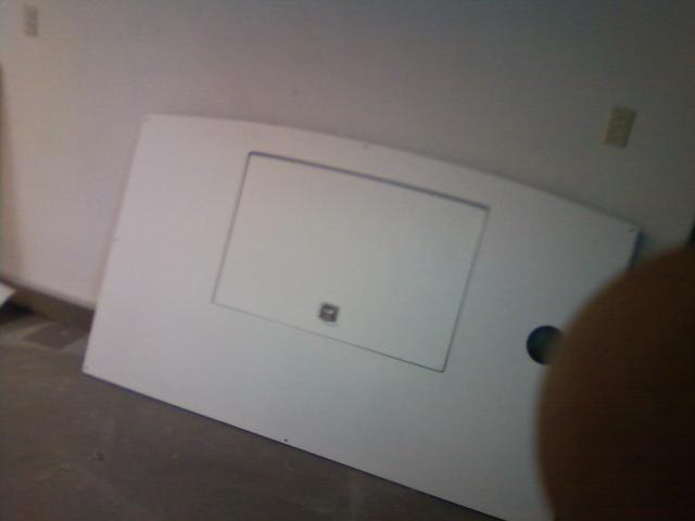

New core, glassed up and painted.
Now wait for some spring weather to get after the rest of the problems.
hatch complete.jpg (16.43 KiB) Viewed 5733 times

Looks good. What's the hole for?
Re: Small Fiberglass Job
Nice work
gitchisum
Posts: 226
Location: Kewaunee, WI
Post by gitchisum »
Hole is for a deck plate. Have the sea cock for for my wash down pump under there.
It was installed by the PO and was done nicely. So I left it.
