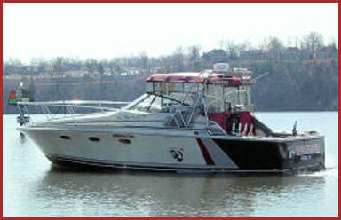

As you can see in the lead pictures for this article, at least a few owners of these boats think they make great fishing boats, and they do because of their huge cockpits and stability. But they also make good cruising boats because of their room both below and on deck, their sea-keeping abilities, and their good ride.

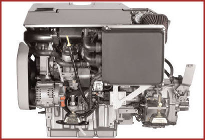

Yanmar 4BY-180 diesel
The Yanmar 4BY-180 diesel develops 180-hp at 4000 rpm. Its compact size makes it ideal for re-power applications.

We think that twin Yanmar 4BY-180 180-hp diesels are an ideal choice for a Trojan 10 Meter re-power project. One could put larger diesels in the boat, but speed was never this vessel's strong suit. And, after all, this boat is a vintage craft being re-powered, so it is wise to keep costs low. We would play to the boat's strengths - good sea-keeping stability, room and comfort. The small diesels give her respectable speed and tremendous range for cruising or fishing.
