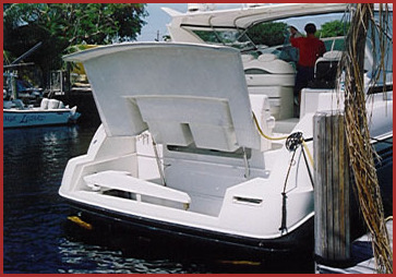

Far and away the first thing to capture attention here is the trunk (I think the English call it a bonnet), which is intended to store your personal watercraft, launched by a nifty electric davit that's tucked out of the way in that space. The space back there is huge, but let's suppose that you weren't interested in a personal watercraft. What would you do with all that space? And what do you do when the electric opener craps out? You can see in the photo below that the amount of leverage on those two cylinders is enormous, causing them to strain under the load.
That deck also opens up 12" above the water line and there are no gaskets here, so water pours in through the unsealed seams. Presumably this compartment is water tight so that a large amount of leakage into it (assume heavy wave action against the stern) isn't going to sink the boat. Gee, even the trunk on your car has gaskets. No doubt that's why the plywood decking at the bottom was starting to rot. Wonder what they were thinking ...

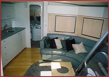

A large curved, sliding door leads into the main salon area which is in the great cabin style with galley contained therein. The entire starboard side is leather lounge seating with entertainment center built in behind it. Huh? Entertainment center behind the lounge, you say? Yes, a small 15" TV is built into the bulkhead on the opposite side, at ceiling level, but the first thing that caught my attention was that the space for your entertainment stuff is behind the lounge. Hmmm. Not exactly the way I'd want it. It's not convenient looking up at the ceiling and not many people have eyes in the back of their heads. Then you've got to climb onto the leather seats to reach whatever you put in the entertainment center. The leather on the L lounge is very soft, and very thin; it's not going to hold up well. Quality material it is not. The seat cushions, attached to plywood backing, are pie-shaped, with the large end in. We couldn't just lift one out to get to the storage space beneath, but had to start at one end and take all of them out to remove one in the middle. Not too convenient.
This is a two stateroom layout with the usual center-positioned double bed in the forward cabin. Its end loading with no side isles. Hope you like crawling into bed on hands and knees. It's fun to try to make up the bed too. Have you ever tried to make up a bed while you are on it? There's no choice because you can't reach the sides and other end. Hopefully your servants will be doing this for you.
The aft cabin is really little more than a sleeping hole with a double berth that's even more difficult to make up than the forward berth. Close the door and the stand up space is no more than a phone booth. I'd really call this a party boat, not a cruiser, so you don't really expect all that much. But the lack practicality is likely to overwhelm the experienced boater at times. The forward head has a nice full glass liner and a wildly curving shower stall of . . . . what, Lexan, Plexiglas? Something like that. In any case, the first thing I did was to walk straight into it. No, I don't have bad eyesight; it's just that it's hard to tell where that "S" shaped panel begins and ends. Maybe after the plastic gets all scratched up it will be easier to notice. I can appreciate modernist design as well as anyone, but this is strictly for show. You can imagine what's going to happen when someone tries a little abrasive cleanser on that. In any event, its definitely eye-catching if you notice it in time. The aft head, with doors to both the aft stateroom and main cabin is decidedly too small, while the salon area is plenty big. The doors get tangled up when you try to open both, and the space is so small that you can't open the vanity cabinet without first opening the entrance door because there isn't even room to bend over. More thoughtful design. Then there's a huge 1" thick chunk of clear plastic acting as a railing for the companionway steps with the Trojan logo carved into it. Some might call it tacky. Others might simply object to having the builder's logo in your face, which, by the way, is rather prominent all over the boat, from the logos in the seat cushions to extra large name plates and stenciling on the transom. It's about like having "Arvida Homes" carved in your front door. Sort of make me wonder how long it's going to be before we start seeing the first Calvin Klein or Tommy Hilfinger editions.

Except for the carved Trojan railing, the interior is for the most part tastefully done in light to dark grays with a backdrop of maple cabinetry and a planked maple floor in front of the galley, which is a decidedly bad idea because it is very slippery when wet. Maple is one of the worst choices of wood to use on a boat, the others being oak and ash. They all turn black with exposure to salt water. Less than two years old and it's already not looking so good, particularly around the leaking portholes.
There is a fold-out, pneumatic maple hi-lo table that is all falling apart at the joints because the carpenters didn't joint it properly. And let me say here that the owner of this boat is very meticulous. I got my fanny reamed good by the owner for not getting the carpeting put back down exactly right. Carpeting which is all tacked down with those nice steel tack strips that are now all rusty, ugly and making a big mess of things. He was probably more mad at Trojan for the unbasted edges of the carpeting that was unraveling and leaving large amounts of carpet fibers all over the place. Apparently you're not supposed to ever lift the carpet and look in the bilge. There isn't much access anyway. And Trojan is still using those nice-looking, but ever-leaking stainless port holes, the leakage being no exception in this boat. The ports are framed out with maple, so I needn't describe what's going on here. These ports will not seal, and you'll have to live with the damage these leaks cause.

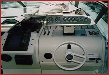

They almost got the ergonomics of the helm right. No one with less than a 44" waist line is going to have trouble standing up or sitting down steering. But from here it's downhill all the way. You can see over the bow just fine, but to take advantage of the windshield wipers, you have to bend over and sight along the deck. Of course, it's never going to rain, so not to worry. I'm not thrilled with the panel design, which is overly fancy at the expense of practicality; all of the labeling is stenciled on with paint, and you know what will happen to that after a few years.
They tried to get fancy with the shift and throttle controls and really botched it. The shifter lever end knobs are only 1-1/4" apart so that when trying to work them independently, the knuckles on your hands collide. I guess the designer didn't know that you have to use two hands to operate them. Or more likely hadn't ever operated a boat long enough to know this. And the narrow, cylindrical shape of the lever ends is decidedly uncomfortable. Here's yet another case of an attempt to get fancy that has resulted in a design disaster. There are places to flush mount instruments, but I wouldn't say that they are quite the right places. Look at where the VHF and autopilot had to be located in the photo below. Now imagine trying to pick out the controls you need to use with these instruments being located at your waist. The Teleflex tilt steering wheel is painted aluminum and is, um, well, you know . . . . . corroding. This is amateur design at its worst.

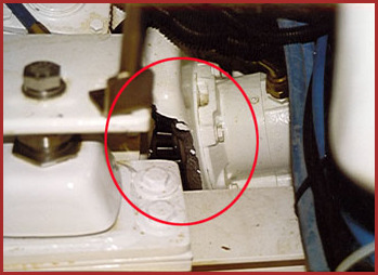

Just so you know that we're not talking through our hat, here's a shot of an aluminum Z-F gearbox broken in pieces. Inside the red circle, the gears are exposed. This boat hit a coral head, damaging only the propellers, but broke BOTH gear boxes in this boat into a minimum of a dozen pieces each. These things shattered like hitting glass with a hammer.

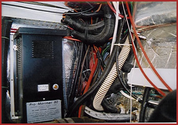

For the price of this boat you'd think they'd do a bit better job of the wiring and plumbing than this mess. Here there is wiring, water hoses, hydraulic hoses and engine control cables altogether.
trojan 440 express wiring

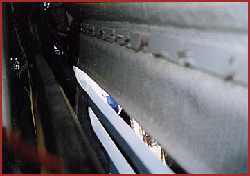

These four hull side vents, up to 40" long are channeling salt spray straight into the engine room. What you see at upper right is the hull/deck join. Imagine what happens when this area bumps a piling.
These four hull side vents, up to 40" long are channeling salt spray straight into the engine room. What you see at upper right is the hull/deck join. Imagine what happens when this area bumps a piling. Performance wise, she's no speed demon, even with a fairly shallow vee bottom running to about 14 degrees dead-rise aft. 840 is not a lot of horse power for this boat that comes in at only 28,000 lbs., but she'll cruise at a solid 22-23 kn. without overtaxing the engines. Figure a tops of around 28 kn. With a 15 foot beam and very full bow, at best she's a coastal cruiser and isn't going to handle big seas very well. It was dead calm on our sea trial day, so we didn't even get a hint of heavy weather performance. The in-line Cats would not be my power choice for this boat if you're a speed demon, instead favoring the higher power 6V92's. Unfortunately, you can't get Detroit's in a vee drive configuration.
